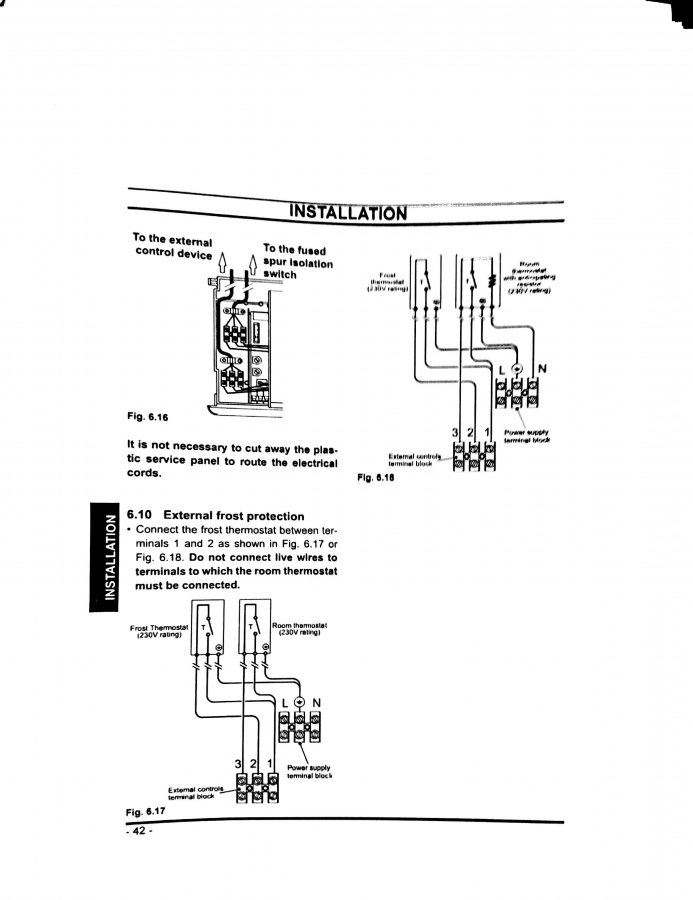

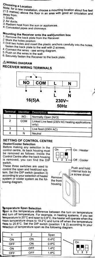

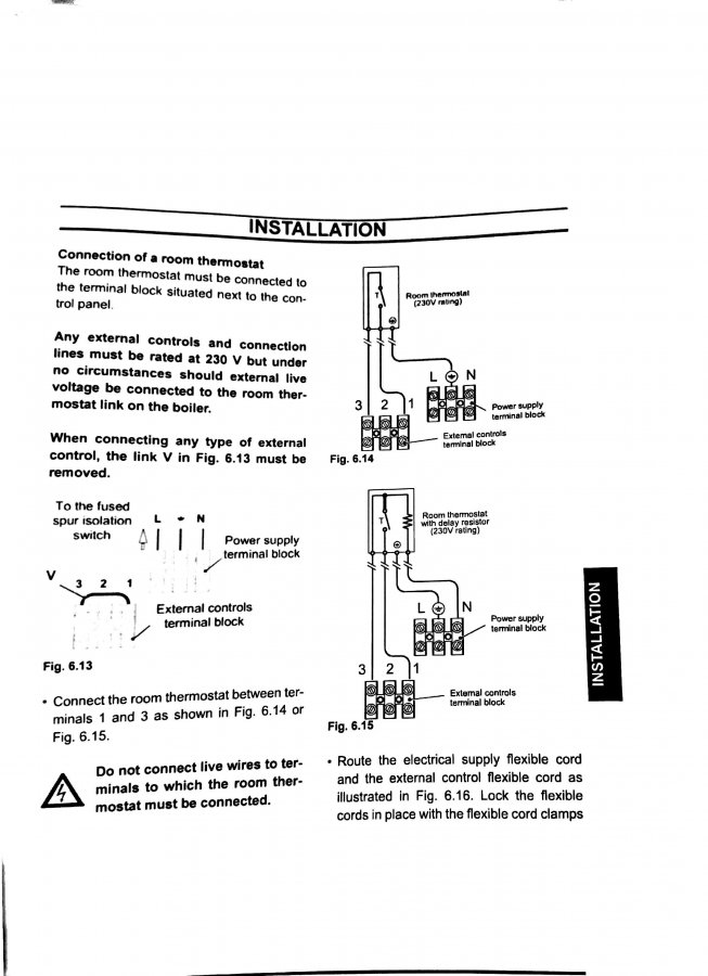

hello, can anyone help me wire that thermostat??
thank you very much!
With that information I would not expect any difficulty in wiring a thermostat.
But take care because those Biasi boilers must be correctly connected as its otherwise possible to damage the PCB inside.
I am having to guess at which models as you did not state it.
