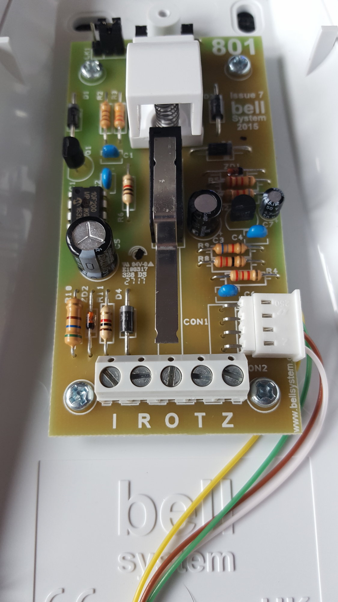

So I took the existing one apart, found the brand name and model number, then ordered a new one expecting it to be a straight switch. Got the new one this morning and annoyingly it's different so I'm hoping for some help.
The old handset had 6 terminals labelled 1 2 - + A B as per the first picture.
The new handset only has 5 terminals labelled I R O T Z as per the second picture.
Any clues as to which wire's go where and which I don't need to wire in? Can I even use this handset, or do I need a different one with 6 terminals? Any help gratefully received.
Sorry, it may look the same but it's a completely different and incompatible type (confusingly they're all labelled 801).
Your old one is probably one of
BELL SYSTEM (BSTL) BC 801

I managed to work around it! Took the handset of the new unit off the base and attached it to the base of the old unit. Works like a charm! Thanks for the help

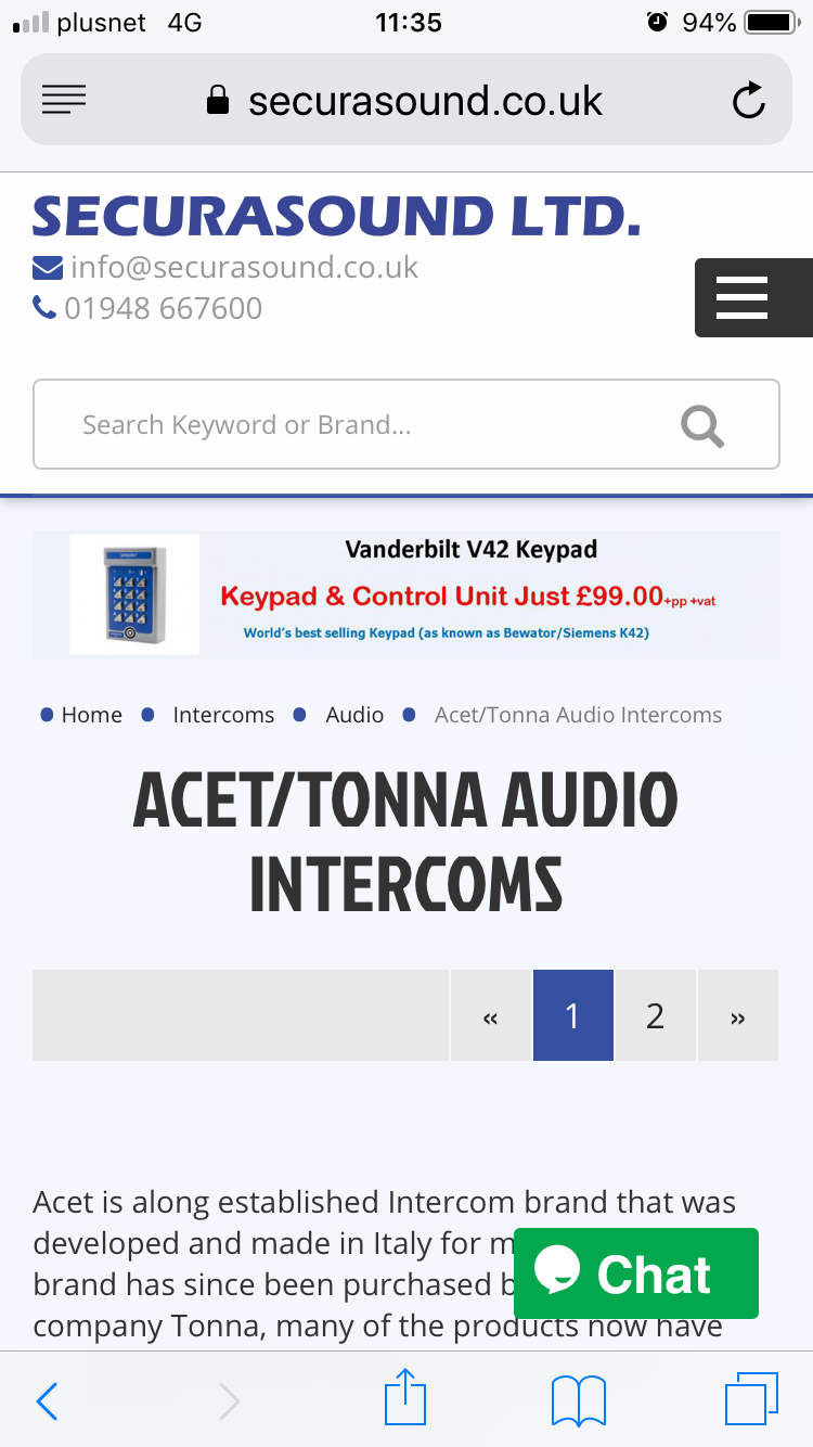

Hi Guys,
First-time poster. Great forum! I've learned heaps from it already.
Posting in this forum as my 'issue' is similar to the OP - and desperately hoping for a swift reply.

Nope ....looks like you have dropped a major ******. You should have checked before buying the bell system unit
Options ....rewire or purchase a two wire system ...

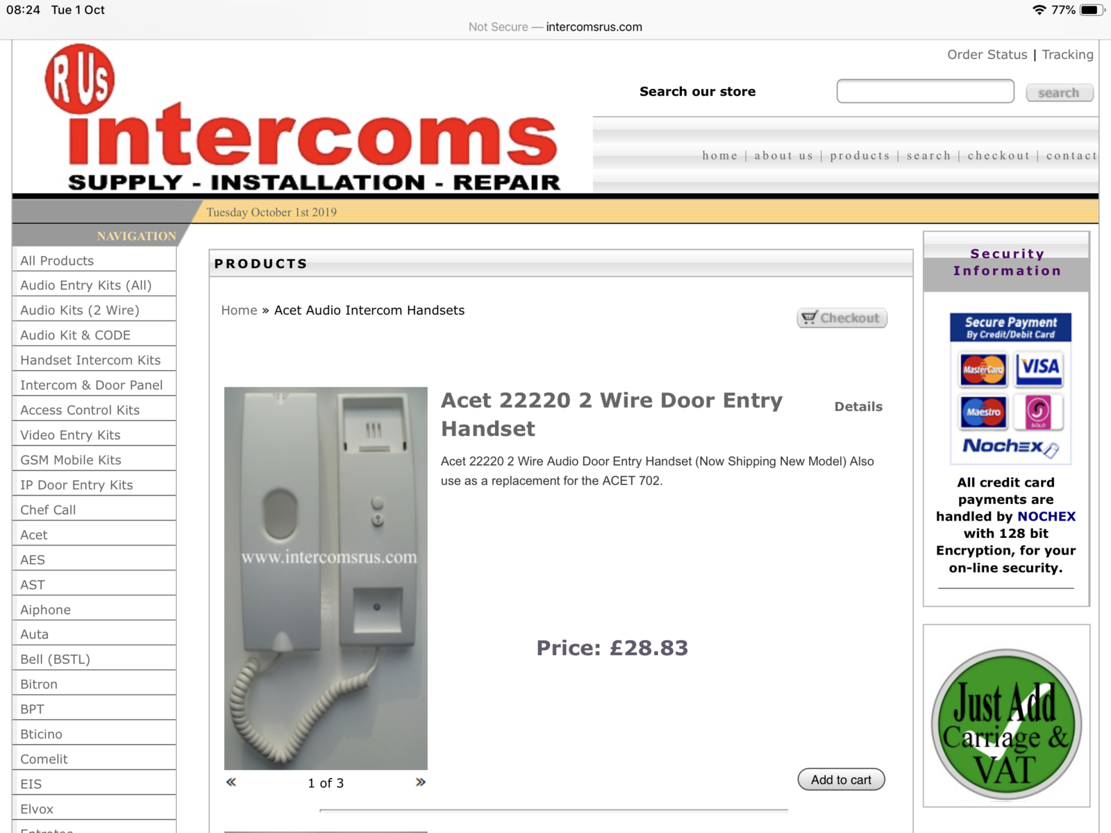

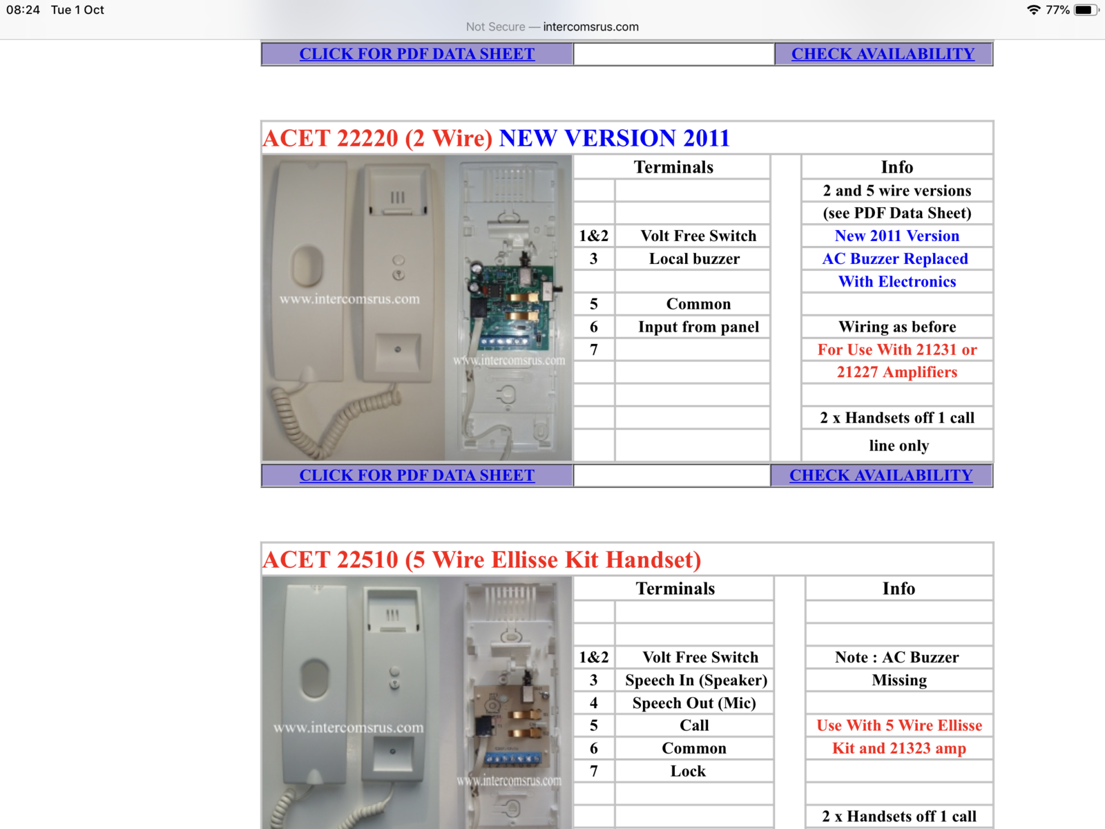

= do you think the 2 wire systems e.g. the Acet system you suggested, would provide 2-way voice (and buzzer, and latch release??)
= do you think I would be able to use existing Acet handsets?
