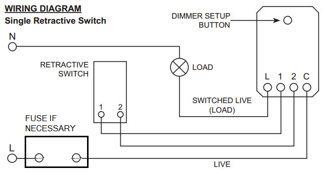

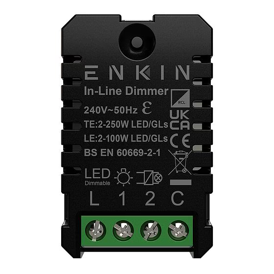

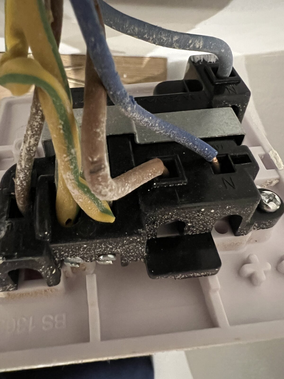

I'm replacing a normal fused spur light switch with a fused spur toggle dimmer switch. The dimmer unit is separate to the switch and the fuse and I'm struggling to work out how to wire it which I hope someone can help me with. I'm a beginner to wiring/electrics and I think what I'm missing is jumping from the dimmer unit to the switch?
Thank you in advance.
I've included pictures of the back of each of the modules/units - The dimmer unit is an Enkin unit as below, the back of the toggle switch, and the fuse unit itself is below.

So question one is why is that fuse fitted? question two depends on one, is it still required?
I would assume a grid switch? To day in the main if I want to dim a light, I use a smart bulb, only with multiple lights would I consider a dimmer switch.
However I simply don't know why yours is wired that way, so can't really help.

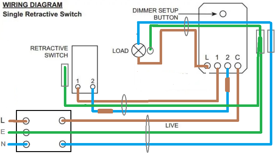

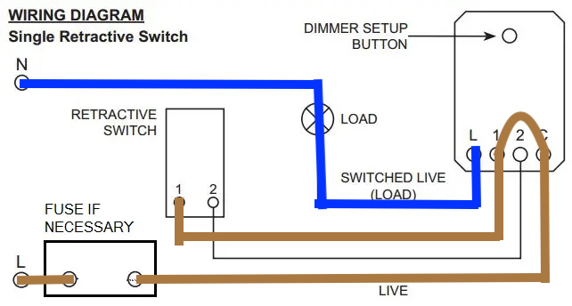

I've tried to mock up the diagram with the wiring as follows:
Is this right? Slightly confused as to where the earth wires go on this.
Is this right?

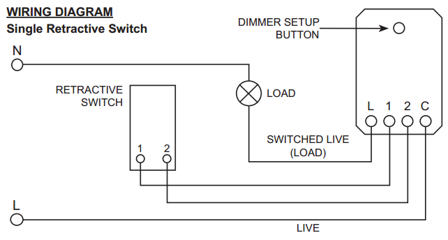

I don't think so.
Why have you altered the diagram and connected COM to 1?
Are you not connecting 2 to 2? A switch with only one wire cannot do anything.
Surely it should be wired as in the diagram.
All earth wires must be connected together at each accessory AND to the accessory if it is required and/or to the back box.
Yes you're right - So I would do Blue 2 to 2.
My confusion is that I will have 3 wires coming in from the Load, and 3 coming in from the Live, so 6 in total.
E.g. where would my neutral load, and where would my neutral supply enter the circuit?

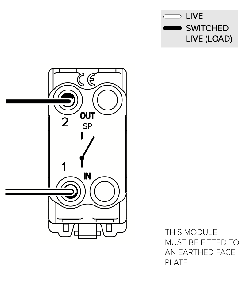

It was previously wired like this as the original fuse spur switch if this is helpful?
Well, yes but it should be sleeved brown (or otherwise identified) to show it is a Line(live).
