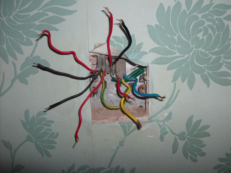

Hi All again sorry new post , got my down stairs light working but haveing trouble wiring up the switch ,
one of the wire if for the porch light wich i no longer use, 'I have trie to wire it differnt ways but it keep tripping the fuse
The red, yellow and blue cable is from up satirs so I have red in com then Yellow in l1 and blue in l2. It the other cable that Im stumped with

1st Mistake Mr ! Looks like it was quite full in that 16mm Back box !
So you have the 3& Earth Core Running the Landing 2 way ?
One of the Twin & Earths would run the Hall (1 way only)
and maybe the Porch was a Feed & Neutral coming into the Backbox , The Neutrals were put in a Connector Block ? and Reds were feed and Switched Live ??
Thats my guess at your Spiderlike Switch Piccy !
Unless you have a neutral present at the switch then the problem causing the trip is not there - it's somewhere else in the circuit.
I'm afraid with all your different topics I've lost track of what you've been doing, but I note you've been at it on and off for 2-3 weeks.
Have you at any time taken a black wire and put it somewhere assuming that because it's black it must be a neutral?
Anyway - you have a multimeter, and here: //www.diynot.com/wiki/electrics:lighting is all the info you need on how lighting circuits work.
