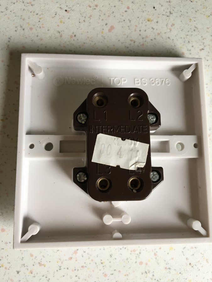

Hi I currently have a light switch which I want to replace. The current switch has 2 holes labelled L1 and COMM with 4 wires going into them. The new switch has 4 holes labelled L1 through to L4. Can someone advise where I should wire the 4 wires please. Many thanks Charn

You have bought the wrong switch. That is an intermediate switch.
It is possible to use it though.
Put the two reds at the top in L1, and the two at the bottom in L3.
If the switch operates upside down, then you can just turn the switch round (!) or move the wires from L3 to L4.
You've actually bought the wrong kind of switch, you have an "intermediate" switch, but it doesn't matter.
Just use L1 and L3 or L2 and L4 (or L1 and L4 or L2 and L3) :)
