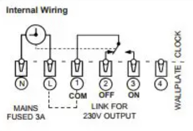

The controller is the master of the system. Download a copy of the manual which will have a wiring diagram in it. Substitute your boiler and stat in the diagram where noted.
The wiring can vary based on whether your boiler requires 230V, or voltage free switching. This will depend on the boiler / method of installation chosen.
For 230V control ONLY then:
The Drayton is wired such that LP111 terminal 3 (on) connects to the live of the Combi Stat (L) and the Combi Stat (3) provides the 'switched live' to the boiler. [which is shown as "LOAD" in the Combi Stat diagram]
LP111 terminal (L) and (1) are linked together [Shown as dotted line in the LP111 diagram]
N & L at the Drayton and N and the Combi Stat are connected to the same 230V supply [ie via the same 3A fused connection unit] as the boiler. Note that most boilers also require a 'permanent live' as well as the switched live from the thermostat.
If you need to use voltage free control, under no circumstances follow these instructions the wiring is different. If that is the case post back and someone will be able to advise further.

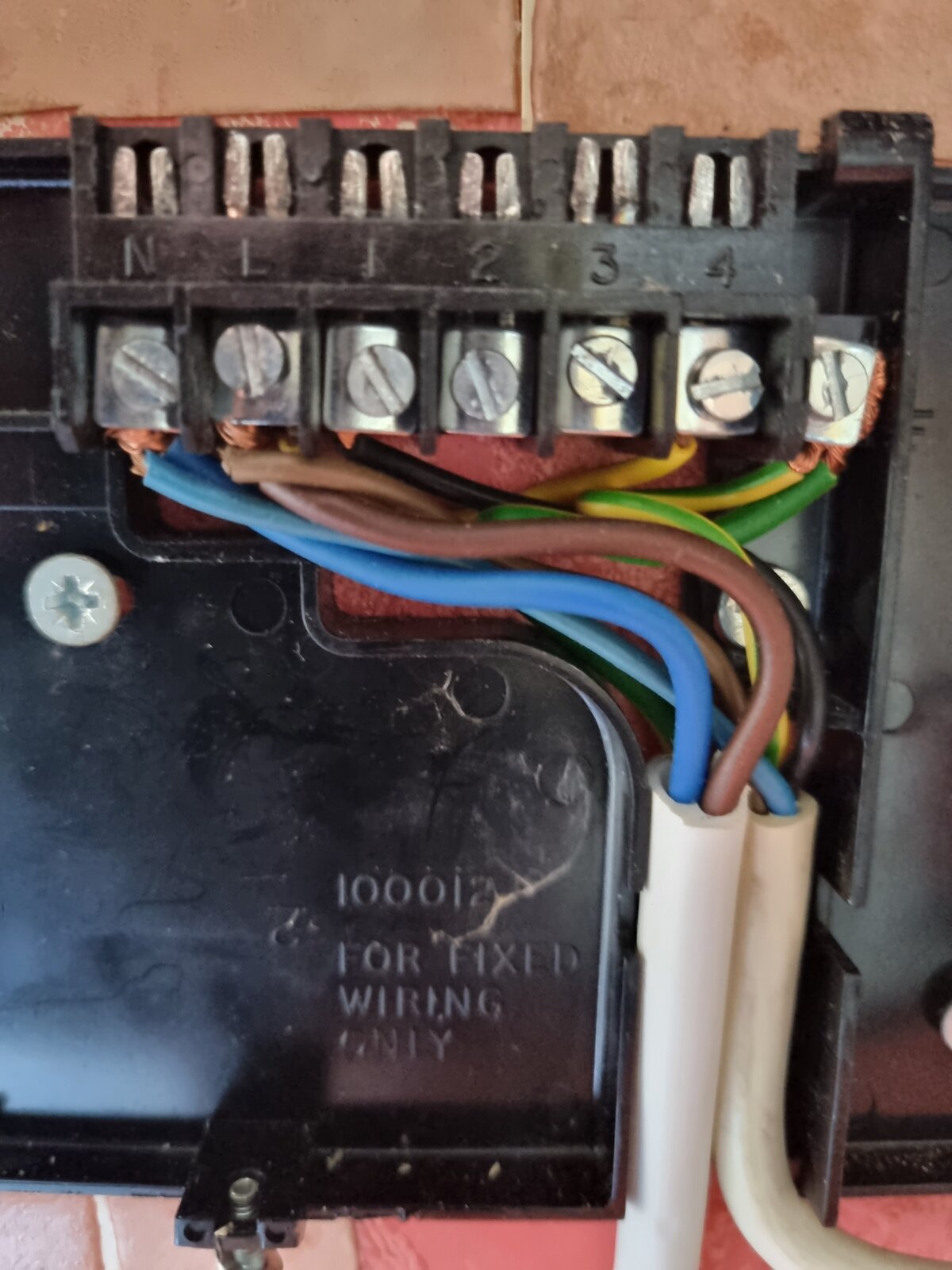

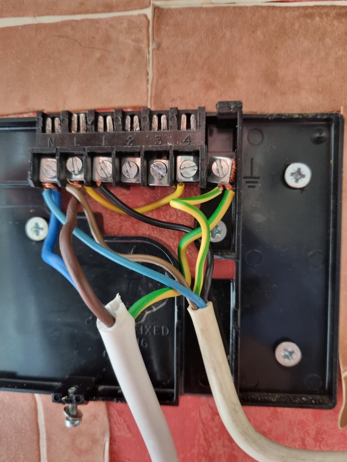

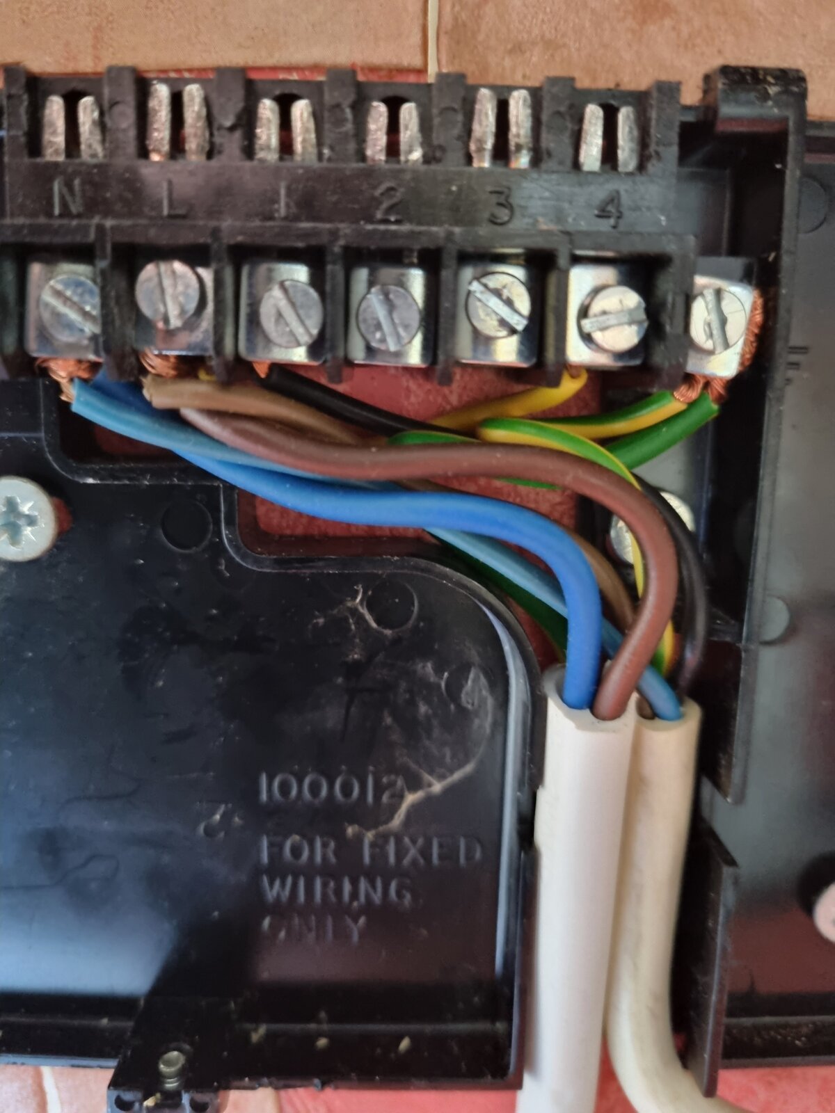

Hi folks, I'm having the the same problems, I have a baxi 80e, and had to swap out my old switchmaster sm 300,and was advised to buy the drayton lp111, so I've just bought the timeswitch but can't get the central heating to fire up,my hot water works fine,so I'm really confused about the wiring?.I have 4 wires from my boiler blue,brown ,earth and a black wire,also have the pictures of the old switchmaster sm 300 wiring, so can someone please have a look at this picture, thanks so much,and appreciated, wayne

Do you have a room thermostat and is it set high enough? I think the common and heating on are also the wrong way around
Hiya ,and thanks for getting back to me,OK I have followed the drayton lp111 diagram, because obviously the old backplate wiring was for the old switchmaster, but be honest, I have tried every combination I could think off,and yes my thermostat is all the way up,? I'm lost ,lol
As you should.
There shouldn't be a need to try every combination! You should only be following the wiring diagram.
First of all, have you used the new Drayton backplate?
Connect the two blue cables to N
Connect the two brown cables to L
Connect the two earth cables to the earth terminal
Use the small yellow cable to connect L to terminal 1
Connect the black cable to terminal 3
Then show us a picture of how you have done!
