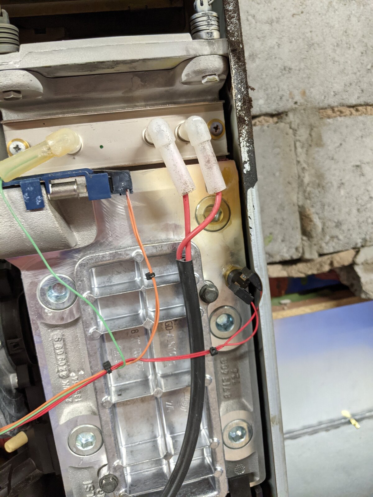

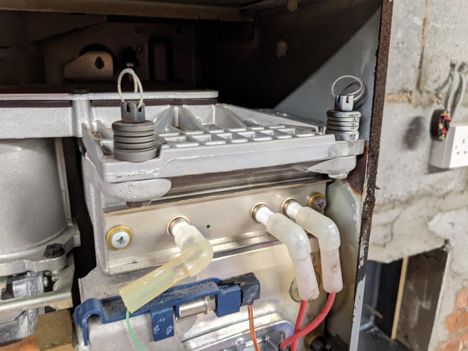

This morning, its back to how it was on Tuesday. Cold upstairs rads, gurgling downstairs etc. So after some head scratching i decided we should try some basic tests before taking things any further. So tonight i refilled the boiler to exactly 1 bar, then closed the iso valves on the flow and return pipes on the boiler case. Before filling, i pulled the cover and checked the pressure in the expansion vessel, 2.5psi, but no water, so potentially an issue there, but as we'll see i think perhaps not the main problem. No obvious leaks inside the boiler, but some concerning marks on the cover and around the top of the primary hex enclosure which i'll get to later...
While investigating, I noticed a gurgling noise, and realised the condensate drain pipe was hot. So i pulled the flexi pipe out of the waste pipe and directed it into a plastic container. Sure enough, every few minutes about 50-75ml of nice brown water gurgled out the pipe into the container. Checked the pressure gauge and noted that it had certainly dropped. Over an hour it had probably lost at least half a bar, and discharged best part of 500ml of water into the container.
So i think that fairly reliably points to a leak in the primary heat exchanger, right?
Now for some additional oddness, two separate points infact.

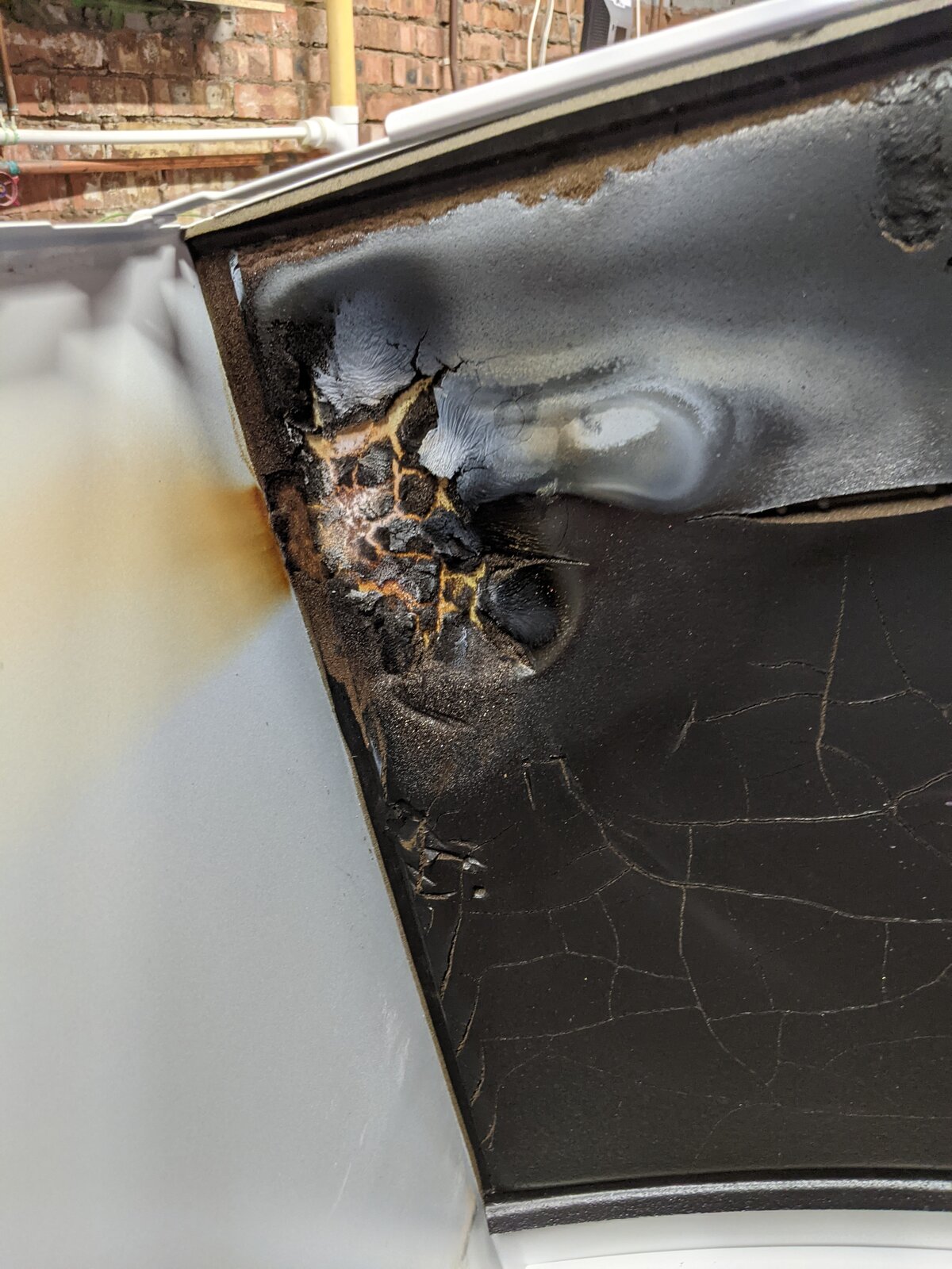

Firstly, the foam that lines the front cover, was badly scorch damaged in the top left corner. On the primary hex enclosure, there was matching deposits on the housing as well as on the side of the boiler chassis. I took some pics of this and i'll upload them. This seems very concerning to me. Its clearly somehow got very hot in this area. This clearly needs proper investigation, and i'll be getting WB back out, however i wanted to know if anyone has seen this before?

Already booked WB fixed price repair this evening and the boiler is indeed turned off! As stated in my first paragraph, thats not why i created the thread!
I just dont want a repeat of last time, and frankly i trust these guys no further than i could throw them. The pump debacle was certainly eye opening as to how poor their diagnostic skills are.
If the charring damage and leaking hex are related and part of the same issue then that gives me a little bit of confidence that it'll get sorted properly. Unfortunately my experiences thus far with gas fitters is not great, and being of an engineering background it always helps to understand whats actually going on.
Can you give any pointers on the "acidity" of the main loop water? Is that normal? If not, is it possibly related to the failure? Clearly if the damage has been caused by the previous guy not doing their job properly, i'll be kicking up a stink before paying for this fix. The reason i have the suspicion, is that they seemed to finish the pump swap in record time. Given they should have been draining the system down to get rid of the chemicals and refilling with fresh inhibitor etc, i'm not convinced they were there long enough to have done it properly. Furthermore, if this failure was caused by some chemical thats been left in the system, i dont want it to go on to damage whatever parts are repaired either!
