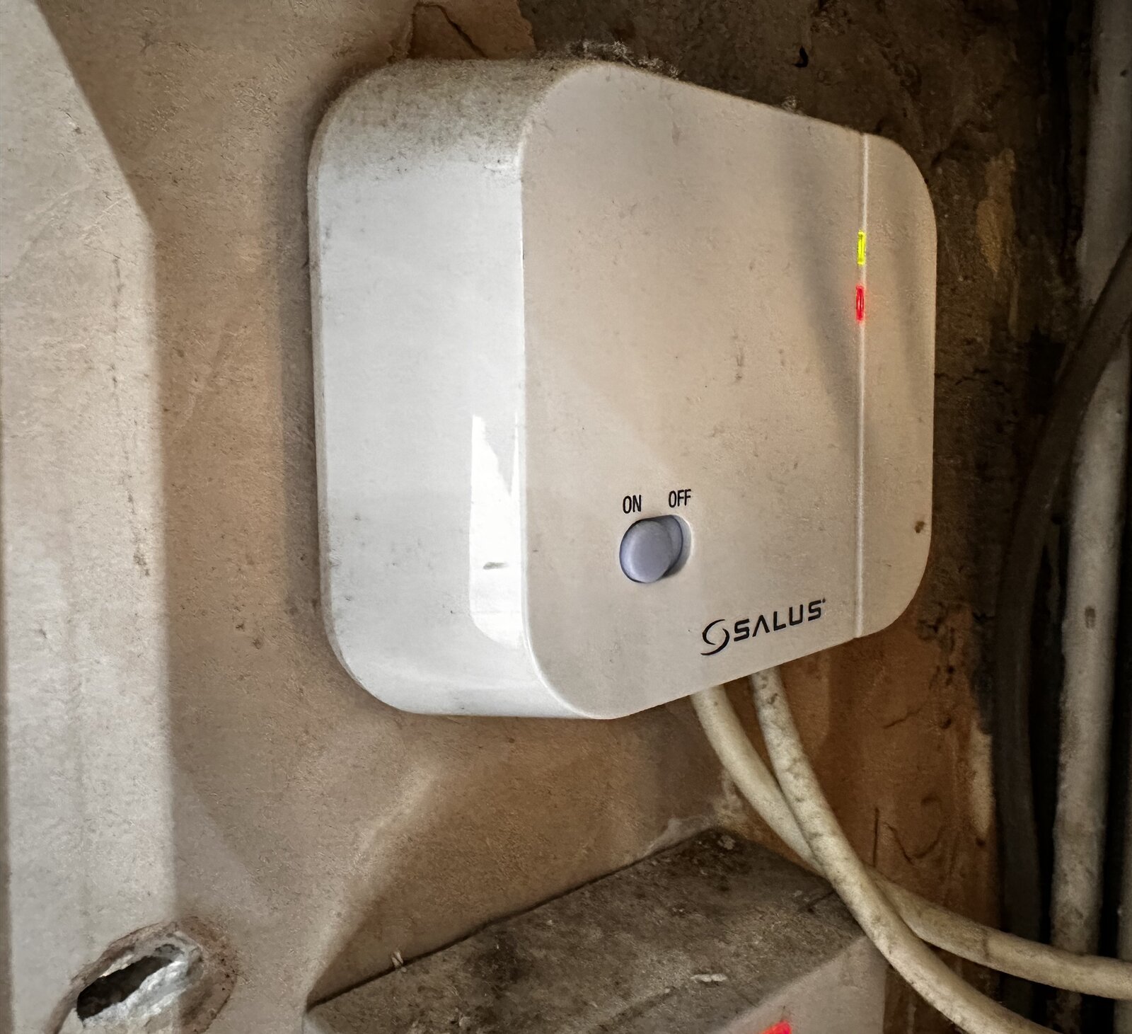

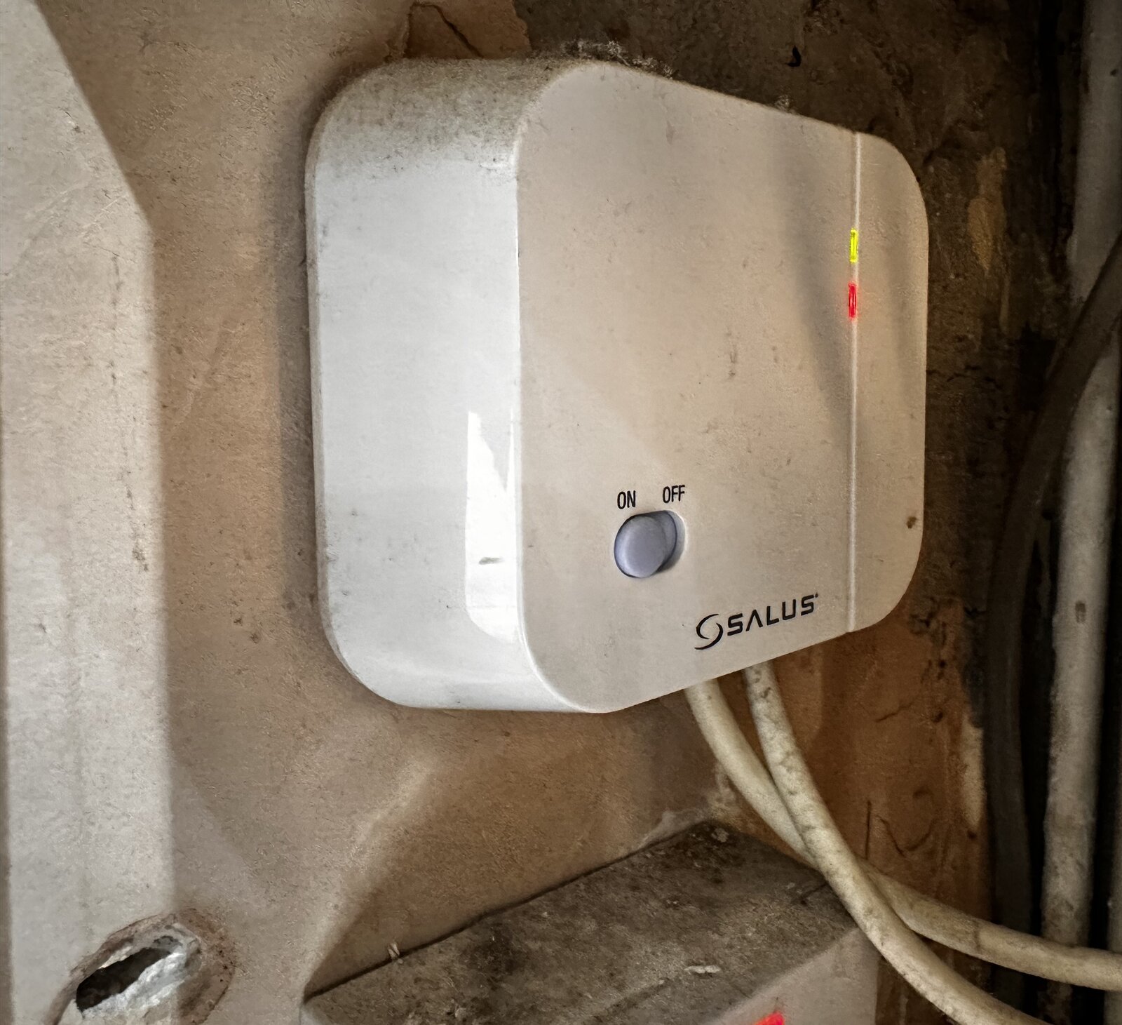

Hi,
My current boiler: Ideal logic Combi 3D
My current Thermostat: SALUS Model: RT500RF
What I like to do: Like to replace my current thermostat with TADO V3+ WIRELESS HEATING and also fit smart TRV.
I would like to know whether TADO wireless thermostat will work out or compatible. more than happy to hear any known issues or better alternatives as well.

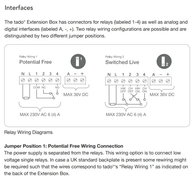

With a combi, you don't need to use the hot water control part, which is there to control the heating of a hot water cylinder. Whilst there is a version that doesn't have hot water control available in mainland Europe, I've not seen it in the UK.

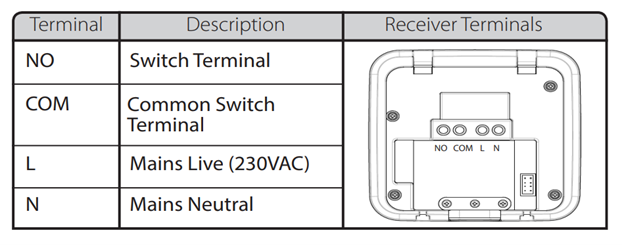

However, a Tado Extension Box that comes with a Tado wireless thermostat can simply replace a Salus receiver. For the 'Potential Free' option shown in the bottom diagram below, you will see that the Tado extension box has the same terminal markings as a Salus receiver. i.e.. NO / COM / L / N
SALUS WIRELESS RECEIVER
TADO WIRELESS RECEIVER
I've no experience of the Tado TRV's but I believe that they communicate to the Extension Box in the same way that the wireless thermostat does.
