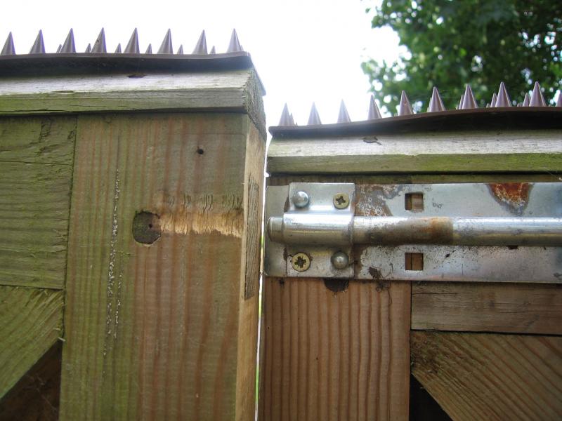

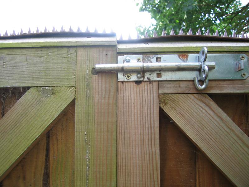

OK, more photos as requested. The top of the gates when shut where the drop is quite visible:
The top of the gates when almost shut:

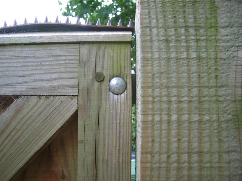

the top hinge from the inside (not much to see really!):
the top hinge from the outside:

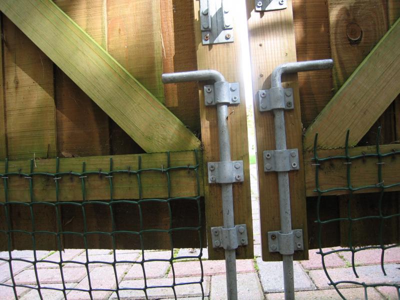

and the bottom of the gates when closed:
I had thought that the gate had sagged but it would appear the 6x6 post of that side is no longer quite vertical.
Glad you found the cause, all you need to do now is apply a remedy.
You will probably have to remove the gate from the post before doing some digging and concrete pouring. Make sure the post is absolutely plumb before you pour any concrete and add a couple of temporary diagonal braces to the post to stop any movement while the concrete sets.
You really want to brace it in both planes, and the less lateral force being applied to the post (i.e. by the gate) the better, at least whilst the concrete sets.
