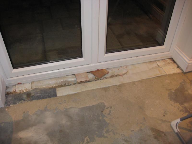

I've been abanded by a builder and am now finishing off the work to a new extension.
I've had some french doors fitted, sitting on a couple of blocks of wood on the outside of the brick wall cavity. The cavity is empty and the inside wall is the height of the concrete floor. I've got a wooden floor being fitted soon, but what do I do about the cavity...does the floor just go over the cavity up to the door? Also, what do I do about the blocks of wood that are supporting the frame? Do i just pull these out and fill with concrete underneath, as I can move them but then you cannot put any weight on the frame?

The cavity is filled with insulation from ground level up, but as you look at the french doors, you can see the empty cavity beneath.
Their is a brick course to support the door frame, but as its sitting on a couple of wooden blocks to keep the frame square, there is a gap at the bottom of about 15mm

Concerning the door, are you saying the wood bits are only 15mm packers? can you post a photo?
Incidentally, why did your builder do a runner?

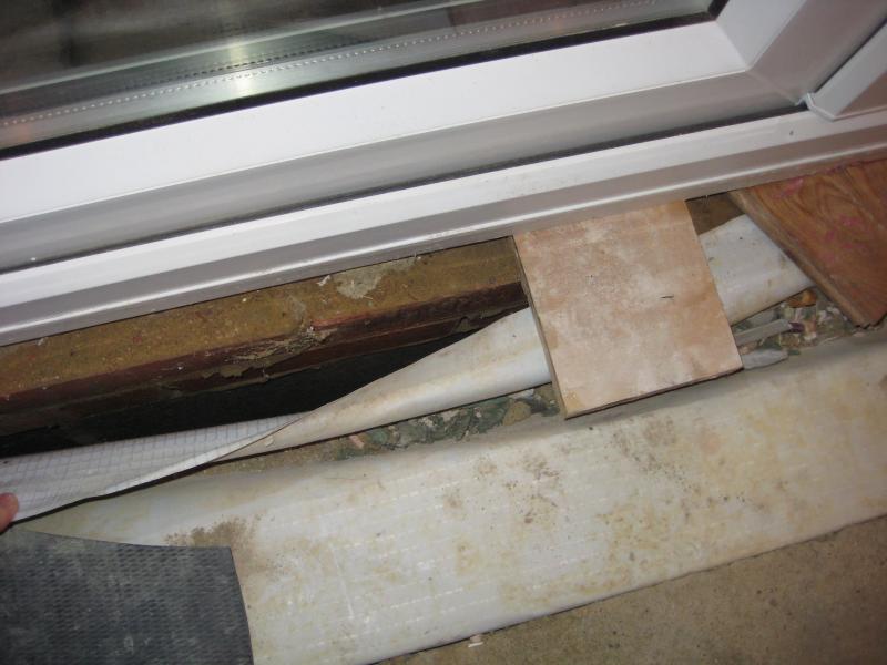

I've attached some pictures.

I don't think you really need the closer; looking at the photos, it seems you have a damp membrane in place under the floor, does the white bit of what looks like plastic go under the floor screed? Is the top of those bricks also the level of the DPC? If so, the builder should have left the plastic DPC in place under the door, is it there? Or is the DPC one brick lower?
Yes the white plastic membrane actually goes under the concrete floor (building control required I had this as we live near a dis-used landfill that emitts a gas, so we have vents underneath the plastic to let the gas escape).
The top of the bricks is the level of th dpc, although there is no dpc where the door has been fitted. You can just see where the dpc has been torn of on the left hand-side of the door.
is this ok? I was thinking of putting the closer underneath the white membrane, so the floor can go on top.
You need to replace the length of DPC under the door; it should never have been removed. Overlap what’s left of the original if you can, if not curl the ends up to the underside of the frame either side. Fit the cavity closer so the outer lip is over the top of the DPC; or instead of the cavity closer, you could put a lump of polystyrene into the cavity & cover the lot with a piece of damp proof membrane. Lay a concrete mix over the lot so that the top of the concrete is level with the under side of the polythene membrane; you will need to force the concrete under the door & point the outside, be careful not to displace the DPC.
Once this has dried, cover it with the white polythene & bring the edges up inside the door & skirting if there is enough spare; if it’s not big enough lay another piece of damp membrane over the whole area & bring this up inside the door & skirting. Finally cover the lot with a concrete screed mix so it’s flat & level with the existing floor. When it’s dry, cut off the excess polythene flush with the screed.
It should have been done with the rest of the floor before the door was fitted & the door frame would then be bedded on silicone. You don’t have much choice now & the screed may be a bit thin but it should be OK Once you get the floor down; don’t lay the timber flooring until it’s thoroughly dried out or it will warp.
