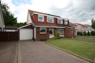

I've posted a similar type of house so people understand what type of house I'm talking about
[/img]

I live in the same type of house as your self, a chalet bunglow with a dormer. I had only been in the house about 6 months when i discovered a leak in the front bedroom, the water was running down the light flex in the ceiling.
so next day i got onto the dormer and found that the felt was starting to crack and blister a bit, but the deck itself was sound so i cut open any blisters on the roof and then i recovered the whole roof using 4 mm cap torch on sheet, including under neath the tiles on the main roof .
It was only supposed to be a tempory solution but that was 10 years ago, i have been back up from time to time to check the deck and it seems ok, my dormer is approx 18sqms, if your dormer is around the same size then the price you were quoted seems a bit excessive, maybe the price quoted was foe redecking as well.
