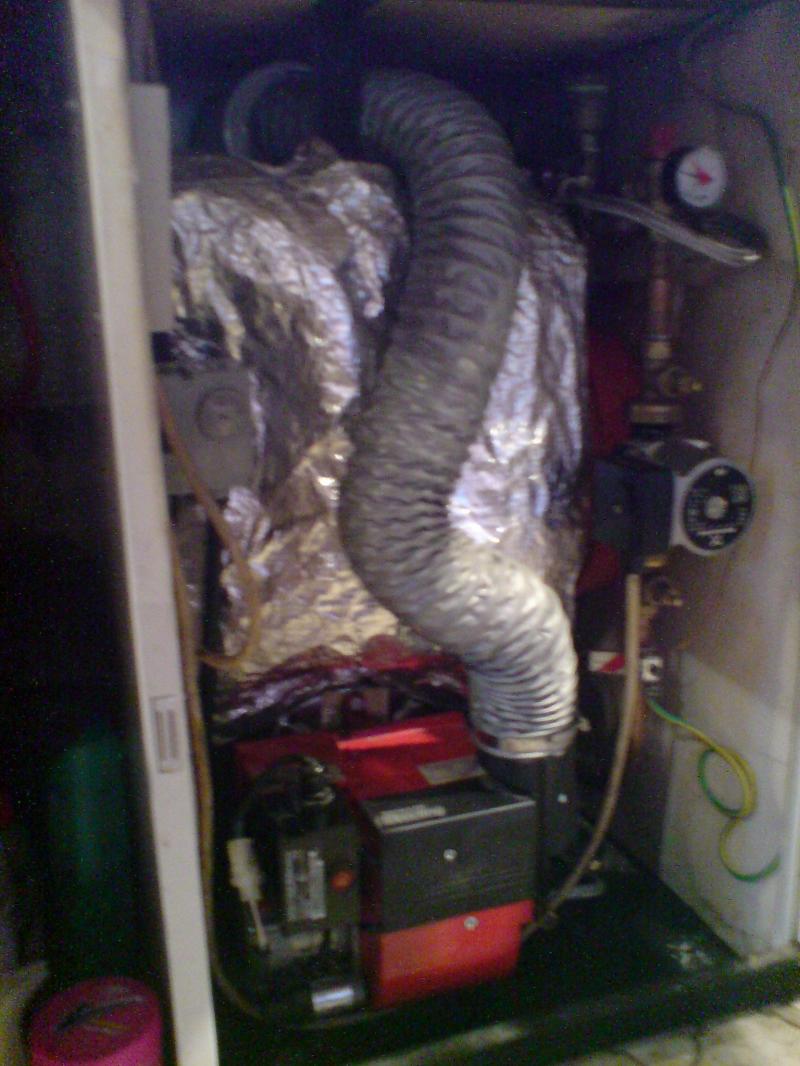

Boiler make / model = Oil Fired Eurocal Ambassador
Problem= Sealed System still Loosing Pressure with no leaks now apparent.
Initial Symptoms= Heating packed up and pressure in CH system found to have dropped to 0.

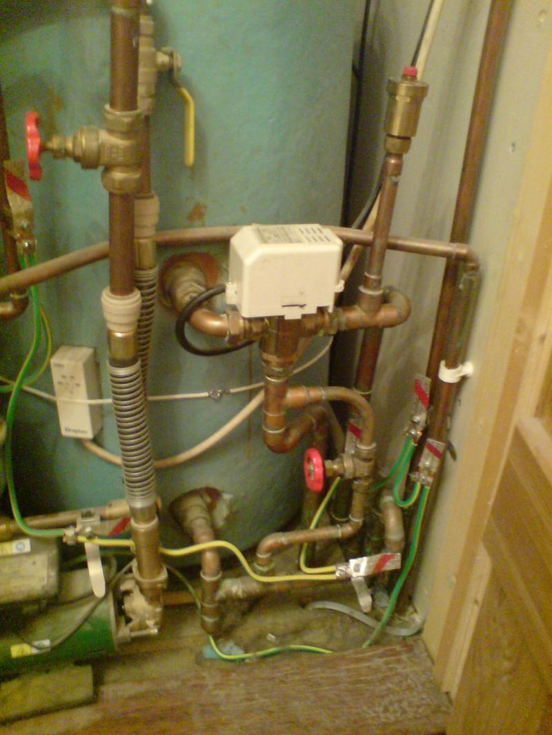

In the pictures, what is the CH device on the right of the motorised valve in the airing cupboard? This has a small red cap with an o ring seal)
What is the similar device just visible at the back of the boiler? (This one has a black cap with no seal and no lid).
What is the purpose of the red stopcock below the motorised valve? (it is normally closed)

The device in the airing cupboard is an Automatic Air Vent (AAV). This releases any trapped air in the system and the red cap should be about 1/2 a turn open.
The device on the boiler is also an AAV.
The red handled gate valve below the motorised valve is used as a system bypass that allows a flow of water should all controls shut down. It shouldn't be closed and usually should be around 3 or 4 turns open (roughly!!)

Red Cap and Valve now positioned as per your suggestions.

I have found the mystery leak at last! After pressurising the system and leaving it go cold a puddle started to form underneath the back of the boiler. The excess water is draining outside through the brickwork at the back so never became visible at the front of the boiler.
There are no apparent leaks in the boiler casing so it seems to be coming out of the bottom of the boiler itself. Could the water part of the heat exchanger have rusted through the bottom in just 4 years?

It is not a problem with the expansion vessel, that is quite accesible and has no sign of any leak. There is no sign of any leak anywhere inside the boiler case but there is water seeping out of the bottom of the case somewhere.
I will have to take the complete boiler housing out to find out how. It is a 4 year old Eurocal Ambassador Floor Mounted Simple Boiler (not the condensing Type).
The heat from the oil burner goes into a large box with baffles and this heat transfers to the water chamber through the back plate of the box. I suspect that it is the bottom of this water (chamber/radiator/exchanger ??? correct terminoligy)that is leaking.
Anybody have any experience of this type of leak?
