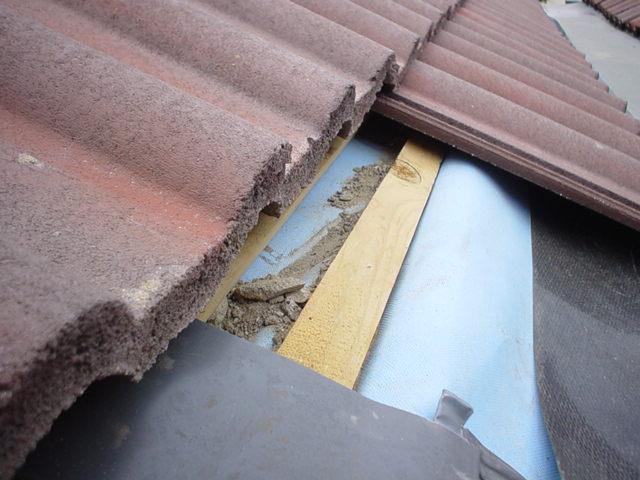

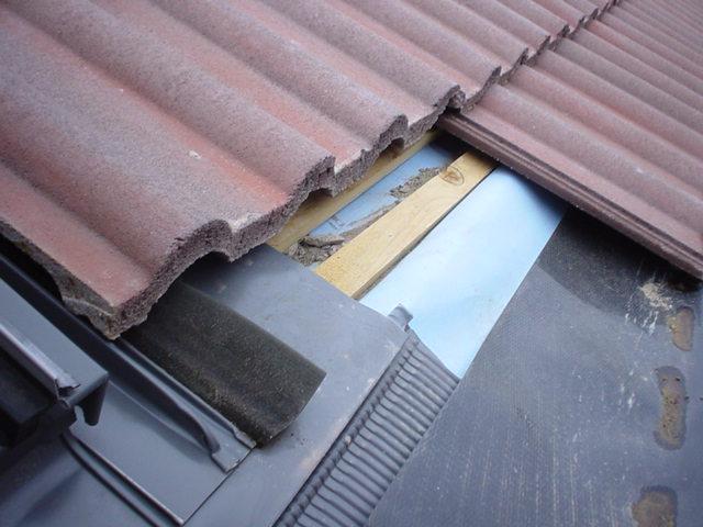

I've had various troubles with my new roof - but I've just checked how the valley is done, and I can only come to the conclusion that it is wrong, but would like more experienced opinions please.
The valley is EPDM (couldn't afford lead), but it is thick Rhepanol.
Personally, I am convinced that I need some sort of support for the tiles (they just lie onto the valley). Could I place some eaves trays under the tiles to stop the front edges of the tiles applying pressure to the EPDM
Also - take a look at the pics:
The membane comes down the slope of the roof, goes under the last 2 batterns and then up over the valley boards (the valley boards lie on top of the rafters, not flush to them). Surely this creates a gutter in the membrane, meaning that if the tiles fail, the water will run down the membrane and collect in the mebrane gutter, and not run out on to the EPDM gutter? Thereby, pretty much meaning the membrane can't perform it's main task.
Also, I've had a bit of trouble with condensation in the cold snap and I'm pretty much convinced this design means there is way to little ventilation from the 'eaves'.

You don't need any support for the tiles and it looks as if there is a plastic tray protecting the EPDM anyway
In theory yes, in practise any water will collect and either evaporate, eventually reach a level and overflow onto the gutter or flow to the end and discharge. Having said that I can't see a purpose to the bottom batten (perhaps it was a temporary fix to hold down the underlay from wind lift) and it could be removed and the underlay pulled down to improve the situation. But essentially water shouldn't get to the underlay - if you have a broken tile repair it. Tiles don't just break on their own
The principle purpose of underlay is to prevent positive air pressure from underneath combining with negative air pressure from above causing tiles to be sucked/blown from roofs easier. Its secondary benefit is preventing wind blown snow, rain or dust entering the property, an incidental advantage is to prevent water coming in when tiles are broken/missing

Sorry, I should have mentioned that it isn't a plastic tray - it is a bit of DPC which they put there when I mentioned that 'surely the end of the tiles shouldn't be resting on the EPDM because any movement in the tiles could be abrasive'. They didn't even think of that. There is only DPC on one side of the gutter.

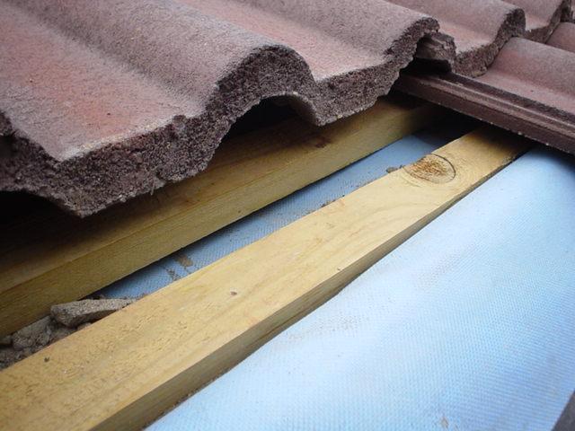

I think it is mainly there to hold the EPDM down at the top of the gutter. I'm pretty sure they've done that wrong as well - cos the top edges of the EPDM goes into the roof space, under the membrane. I'm thinking that surely all EPDM should be totally sealed to the substrate?

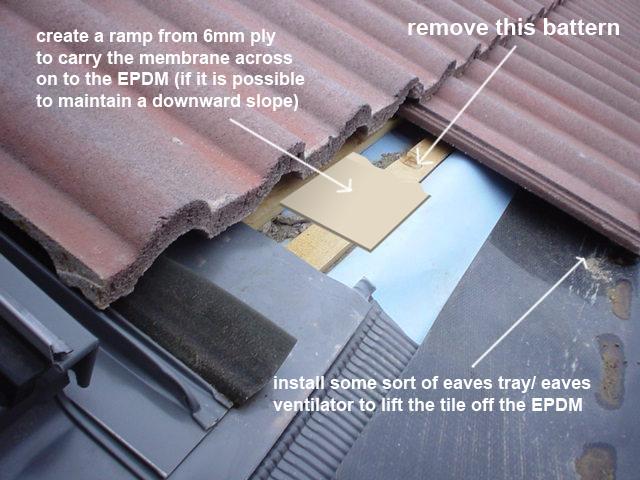

I'd prefer not to see any tile edge in contact with any valley felt (or lead) as there is a risk of perforation.
IMO, there should be a tilting fillet to lift the tiles off the valley EPDM
By the looks of things, any water running down the membrane is going to be held at the bottom as there is dip and a trap there caused by that bottom lath arrangement. Standing water at this location is not a good thing
My concern would be the longer term performance of this arrangement, as things start to weather and settle
IMO, I would have specified some 6mm ply to let the membrane from the roof lie nicely over the valley EPDM and then a lath and tilting fillet with some drainage slots cut into the back fixed to this .... and/or some eaves vent tray to kick the tiles up and allow drainage from the main roof
and that is what you should look at doing! it will also give you an airflow under your tiles.
i think he has shoved the dpc below this row of tiles to try and conceal this dip. looking at the longer term this is not ideal and should really be sorted properly.

I think the main reason that this trap has been created is that they didn't lay the valley boards flush to the rafters - it sits on top, so the mebrane has to jump up about 20mm to get over the edge of the valley boards.
I know 'Roofer' was saying I was picky, but bad design fails eventually, and this design just hasn't been thought through - even I can see that as a layman.
I think the only solution, without ripping too much stuff out and redoing, would be as shown in the new picture - but maybe I'm wrong???
Whilst it is not standard practice (and therefore not a fault in the roofer's work) I agree that some sort of protective layer would certainly do no harm and may have beneficial qualities.
With regard to the valley construction, this once again is standard, the layboards are always installed on top of the rafters; only pitched valleys have the boards inset between the rafters. Your proposal to install a strip of ply has theoretical benefits but what water are you trying to remove? If the roof is done properly then there is no water on the underlay.
Let's all be honest here - this is the way that it is done in 99.9% of cases - it is totally acceptable practice and there is no in-built latent defect!
