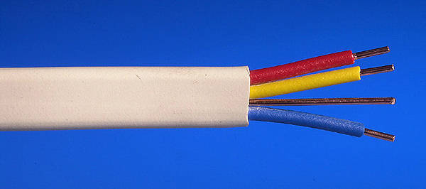

I want to have the layout of such: Electric from breaker box, to one light then the next light then to a switch. But I do not know how to make all the wiring connnections. Any suggestions?
you want the switch to control both lights?
if so then between the two lights you need your contries equivilent of three and earth
(the picture is british so the colours of your wires will be different)
so from the breaker box you have a cable carrying neutral ground and unswitched hot
in the cable between the two lights you have neutral ground switched hot and unswitched hot
in the cable to the switch you have ground switched hot and unswitched hot
the lights connect to ground (if they have a ground terminal) neutral and switched hot
the switch connects to ground (if it has a ground terminal) unswitched hot and switched hot
one of the hots to the switch will probablly be taken down a white core. This should be labelled with black tape or sleeving at the ends
one further thing you may need some terminal block to join the unswtiched hots together at the lights

I'll start with a proviso that if you're not sure how to do this, then you really should get somebody to at least check your work before turning on the power. That said......
Run 2-core (plus ground) Romex from panel to first light, 3c+gnd from first light to second light, then 2c+gnd again from there to the switch. 3-core Romex will normally have the cores colored black, white and red.
The feed from the panel will be hot on black, neutral on white as usual.
At the first light, connect the white from the supply cable to the white on the 3c, and also connect this to the white/neutral on the light. Connect the black from the 2c supply cable to the red of the 3c cable. Finally, connect the black from the 3c to the black/hot side of the light (on a normal ES fitting the hot must go to the center contact, neutral to the screw shell).
At the second light box, connect the 3c white to the lamp's neutral/white terminal. Mark the white wire going to the switch to show it is a hot wire, and connect it to the red of the 3c cable. Finally, connect the black of the 3c, the black going to the switch, and the black/hot side of the lamp together.
Grounds should all be connected together at each point as usual, of course.
If the breaker supplying the circuit is 15A, then #14 cable would be the minimum size; if it's 20A then you need at least #12.
