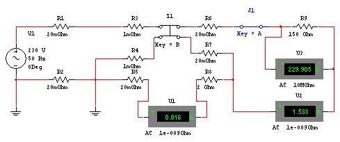

OK here goes.
I have a split consumer unit that is wired normally. One of the MCBs on the non protected side (I have checked that the neutral is on the non protected neutral block) trips the RCCB when ever the MCB is reset. The MCB does not trip itself, it just trips the RCCB! So I am unable to have the MCB (remember its on the unprotected side!) and the RCCB set at the same time.
The MCB is question is on the non protected side so how can it be tripping the RCCB?
Do I have an earth leak on that MCB?
Any other help would be much appreciated.
Thanks.

PostPosted: Tue Jul 07, 2009 1:32 pm Reply with quote
If you look at first diagram I show an earth neutral fault.
Now on second diagram I show same fault with an extra load going to a item which is not faulty
This shows how a device on the non protected side can cause a neutral earth fault on protected side to exceed the level where the RCD will trip.
I have used a program called Multisim which simulates electronic designs but also shows what happens with simpler circuits I have given each wire a resistance under an ohm and loads with ohm resistance.
So you are looking for a earth neutral fault on the protected side. I would look at heating applances first as many use mineral insulated cables which tend to absorb mosture and many only have switches on the line so although switched off can still give you an earth neutral fault.
Switch the isolator off on cooker and imersion heater for example.
eric- if you have a moment, would you be so good as to redraw your diagrams in the context of a split-load board?

PostPosted: Tue Jul 07, 2009 11:06 pm Reply with quote
too many resistors to follow.. hurt my head the first time I traced it out too... icon_wink.gif icon_lol.gif
