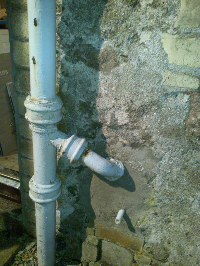

Hi, hope you can help, i am changing my kitchen, i need to add a new waste pipe thorgh the outside wall and join it to on old cast iron down pipe, see pictures, it 40 ft tall, can i break into this without having to replace the whole thing?

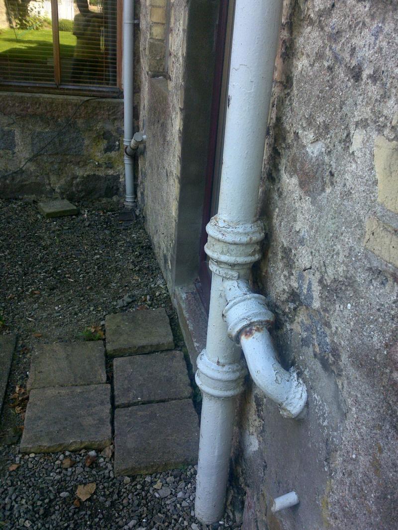

What is hiding behind the timber in pic 3?
That "soil pipe" looks like its just a vent stack !!!

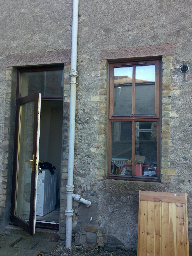

hi buck55, i am moving the sink to the other end of the kitchen so i can join it to the current waste, the pipe goes all the way up with a vent on top, there has been a pipe fro it going into/out off the kitchen long before i lived there, the wooden thing outside is a book case waiting to go to the dump. cheers
where did the waste from the kitchen sink go to in the past???
Is there a gully behind the book case???
hi, i have added more pictures, the exising waste pipe is the other side of the door about 10 ft away.
I'm not a plumber but what am I looking at here, it looks upside down.

the exitsing branch has not been used for many years, it goes through the wall, but dont know what it was used for.
There is a drain running along wall under the surface, i think this is the vent pipe for this
