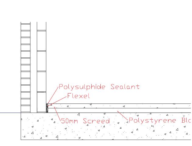

I'm currently in the process of attempting to design/build a new garage at home. I've opted for a rc slab with the brick/blockwork commencing at the top of the slab which is roughly ground level also.
What is the best way to lay/route the DPM? I originally thought about putting it under the slab but i'm now thinking about raising the floor inside the garage (for insulation) and this gives me an option of putting it above the slab.
From looking at the attached drawing. What would be the best way to route the DPM and tie into the DPC.
Thanks for any assitance.
Simon
Firstly i would form the concrete with a 150mm step around the perimeter to allow the 150mm difference between the outside ground level and the DPC.you then need to cut some blocks down to 150mm or use 2 course of bricks on the internal leaf.then lay 150mm DPC in the brick/blockwork so 50 mm is protruding into the garage..
lay your insulation and then you DPM and lap the 2 together.you will need more than 50mm screed if youre driving a car over it.

you can just thicken the slab around the walled perimiters.
See DPM / DPC detail below:-
hth
hotrod, in your diagram, are the strip and the floor poured together, or strip and dwarf wall first?
I thought the wall strip would be deeper/thicker than the floor?
Hi John, that diagram is purely a DPM / DPC detail and makes no detailing for foundation design as this would vary dependent on design (e.g. raft / trench block / trench fill etc). You are correct though, in that a traditional strip the trench would be deeper than the slab, so in that respect the diagram could be misread. But, like I said, it is, and is notated as, a DPC overlap, so the foundation detailing would never be used on site as a working drawing. Hope that clarifies.
