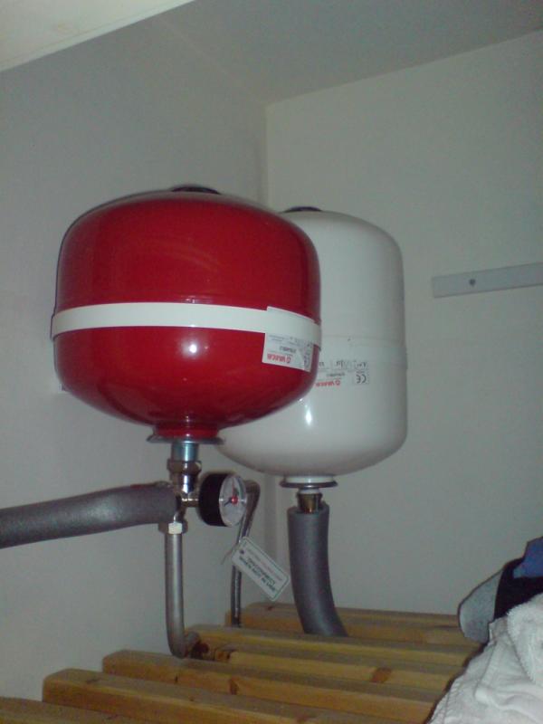

Hi, I've just moved into a new house with a Glow worm 18hxi boiler. I keep getting an F1 fault and it turns itself off. I have little info on the boiler and the estate agent (its a rented property) says I need to check the pressure of the system before they will send someone out to help, and then not help me with how I do that! :evil:
How do I check the pressure, being a complete newbie to central heating as my previous house had storage heaters?
I read some where that it could be the PCB(?) a filter box or a seal somewhere. Does anyone have any experience of this and what I can do to check the pressure?
Thanks.
The hxi is supplied as open vent so may not have pressure gauge. Look in your loft, if there is a small 4 gallon tank connected then there is no pressure to be read.
Thanks Tibbot. I have looked in the loft and there is nothing, as this is a 3 storey house, I have the water tank on the middle floor. In the cupboard are two smaller tanks, see below:
Is it the white one? What else can I check with the boiler to see what is faulty?
in your pic, to the right of the pressure gauge (on the red expansion vessel) is a silver braided hose
follow this hose until you come across a 1/4 turn black handled valve
open valve slowly until gauge pressure reads 1.5 bar
Thanks for that, there are two 1/4 turn valves on this hose. Have turned them both slowly to open and the pressure has gone up, but only to 1.1. I've put the heating on and turned it up but it isn't going up.
Is 1.1 bar satisfactory?

in 99.99% of times its more than ample
all external controls calling for heat??
have you reset boiler?
Thank you glasgowgas. Yes, I have reset the boiler. I'll see how that goes for now.

Anyway, back to the subject at hand, the gas is on and working, the boiller has just been shutting off randomly. It came on this morning ok after opening the 1/4 turn valves last night, so I'll see how it is when I get home.
When you say opening the black valves, I hope you mean closing them when the pressure reached 1.5 Bar?

Yeah, I opened the valves, the pressure increased to 1.1 Bar and have closed the valves again as the pressure did not go about 1.1.
As for the ignition fault, I have read that it might be because of low pressure. The boiler has not gone off today, so this may have resolved the problem.
nothing to do with pressure. Your boiler is heat only and does not record low pressure faults. In the case of extreme low pressure it may give one of a few fault codes relating to circulation.
It will no doubt return and you should get it checked out. If the boiler is pre 2005 and hasn't been properly maintained it may need a safety critical seal replacing.
