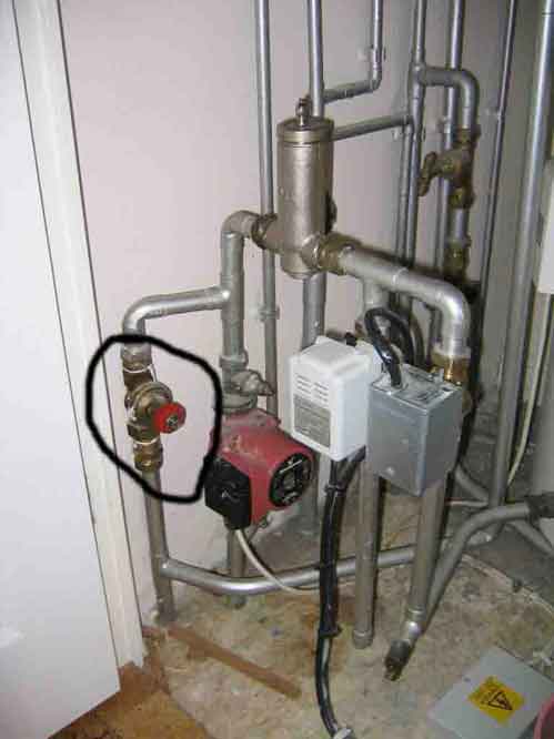

Hi,
I have a sealed CH system and I have a valve which I don't know what its purpose (See pictures below) is. The pipe that feeds in to it is the Primary return of the HW but it also can go below, I guess to the boiler. Could you please advice me what is it for and shall I keep it open or closed?
PS It can be turned endlessly clockwise and anti-clockwise.
Thanks in advance for your help
Closer View
unfortunately things are not working fine with my CH problems with air in the system etc. as a result of which I've tried many things and once of them is turning this valve so I don't know what was it's initial position that is why I was looking for some advice.

If the large, vertical, cylinder like, silver fitting in the pipe work above the pump is an automatic air vent then this might be the source of your problems.
You could try and turn the cap anticlockwise and see if air comes out, but the best solution would be to get the original plumber back.

Thanks for you constructive answer unlike the useless one above, which is not even worth the effort to type it. The cylindrical thing is an auto air vent but how this once can be the source of the problem? Do you recon that it may be some air stuck in the bypass and I can release it turning the red handle (which obviously is not missing kevplumb)?
Kevplumb what is the red plastic collar for? I would really appreciate a constructive answer.
right in your pic there is a brass shaft with two flats on sticking out of the valve .
the handle to turn it on or off fits on there its been removed to stop people doing exactly what you want to do ie alter the setting .
try a small spanner on it and remember how much you turn it
the red bit looks like a cover .
Kevplumb thanks for the answer. It all makes a lot of sense and this is what I thought initially. However when I turn the red knob the brass shaft is turning with it until it clicks and then I can keep turning it until it clicks again. I'm not sure when it clicks is the valve in a close position or is it regulating the valve at all?
it is possible to close an auto air vent so it no longer functions correctly. Try turning the cap anticlockwise.
This particular auto airvent is a bit different type the the one I have in my boiler with the cap open 1.5 turn. The one in the picture can release air/water when I push the cap but the cap itself can't be screwed. I also tested that it works fine automatically when I filled up the system some air was release during fill up.

This valve seemed to me some kind of pump bypass and I thought to check whether it is closed or open. However as I said in my first post I couldn't figure that out because when I turn it clockwise the only thing is that I hear a click after few turns but it keeps turning after that. It turns endlessly anticlockwise as well.
