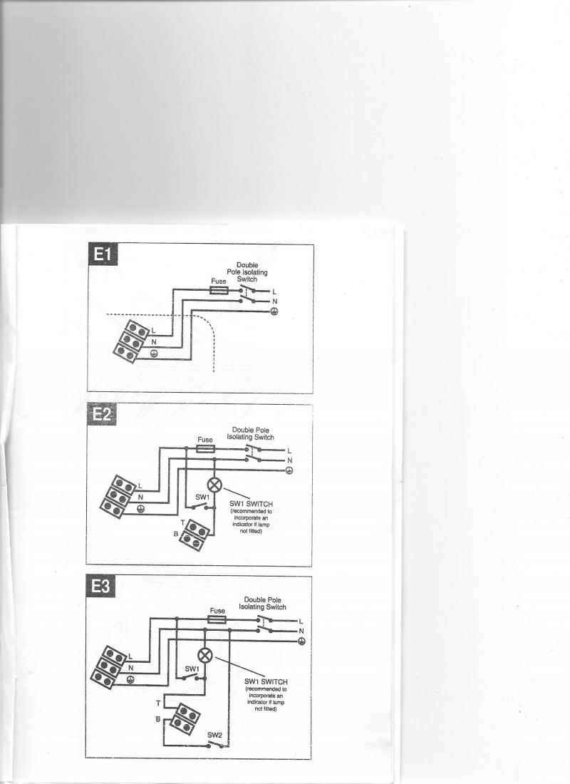

I have a expelair gx6t to replace my old fan and am confused about the wiring diagram it seems to be showing a switched dead short or am i missing something I thought you just had to provide a permanent live to the timer connection my unit is dia E2
The permanent line provides the run on after switching off the switched line. You need the switched line to trigger the fan. The centre diagram shows an indicator lamp between the switched line and neutral. The switched line also goes to the aux. connector.
The diagram is a little difficult to see.
E3 is interesting.
Maybe someone should tell Xpelair about 132.14.1, 530.3.2....
If they do say that, I don't know where. I know where they say that equipment shall be installed in accordance with the MI, but not sure that equates to the MI having precedence over the regulations when they would involve a clear contravention.
There's also 133.2 to consider - maybe it would be a contravention of the regulations to select an item of electrical equipment which requires a contravention of other regulations in order to be installed?

Thanks for all your replies its all sorted thanks to your help a bit of common sense and of cause ignoring the instructions
