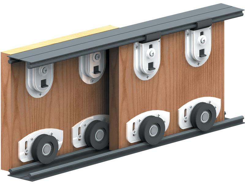

I'm going to use the the sliding door gear as pictured below, and the size of one door ca. 1 m wide x 2.6 m high.

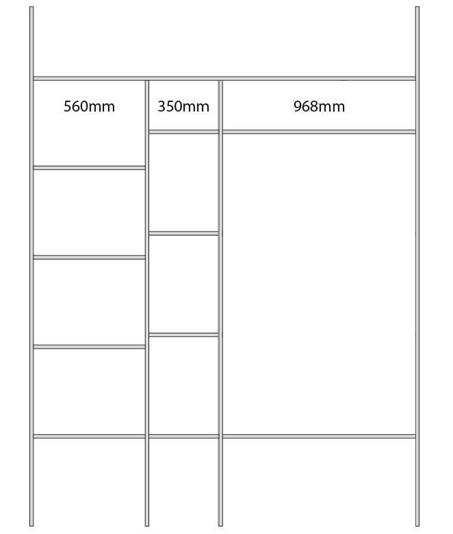

shelves over 700mm in length will need support every 500/750mm
Thanks for your reply! I was thinking about a layout like that (space for clothes rail in the middle). I guess that there would need to be support somehow in the middle...
Hmmm, would be a shame to have another vertical division and cut up that large space.
You could put a divider between highest shelf and top of the wardrobe. The then any sag would be supported from the top.
Same at the bottom.
Or you could use a length of 2x1 fixed to the edge of the shelf (wide side out) to act as a support.

Yes, we were still debating what interior arrangement we'd have. We want to stick with 2 doors, so one possibility would be this:
2x1 -- is this a batten screwed to the edge? Yes, last night I was thinking of that as well. Seems like a good solution.

the trouble you have is your rollers wont take the weight off 3/4 off a sheet off 18mm mdf
Apparently, these rollers take sheets of up to 70kg http://www.valcomp.pl/eng/?set=meblowe
I've seen somewhere that a full regular sheet of MDF is about 40-50kg, so I should be well within the limit. I'm also considering whether ultralight MDF would be better in any case, but was wondering about its rigidity.
the thickness of the material will also be governed by the distance between the tracks but suspect 15mm will be the recomended
It also seems that the tracks are made for up to 18mm materials. For weight reasons I was thinking of going thinner, but am worried about the MDF at 15mm being rigid enough to stay straight long term. Any take on that?

if i was making a wardrobe that size it would have 3 equal hinged doors on 3" pillars with 3" flush hinges overlaping 25m or kitchen type hinges with a 1/3 width pillar
sliding i use top roller track system then weight cannot bend the doors

shelves 12mm mdf fronted with 2x1" planed rebated 12x12mm wood laid flat for 750mm spans or less greater than 750mm large profile showing but no greater than 1200 without further support
if the shelve is supporting the hanging rail half the spans above

Hanging the doors doesn't seem easily possible: ceiling and walls are plaster board. Hence I was thinking of bottom rolling. It sounds as if MDF could bend with bottom rolling system.
