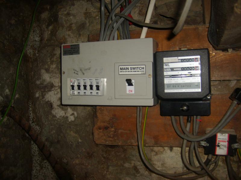

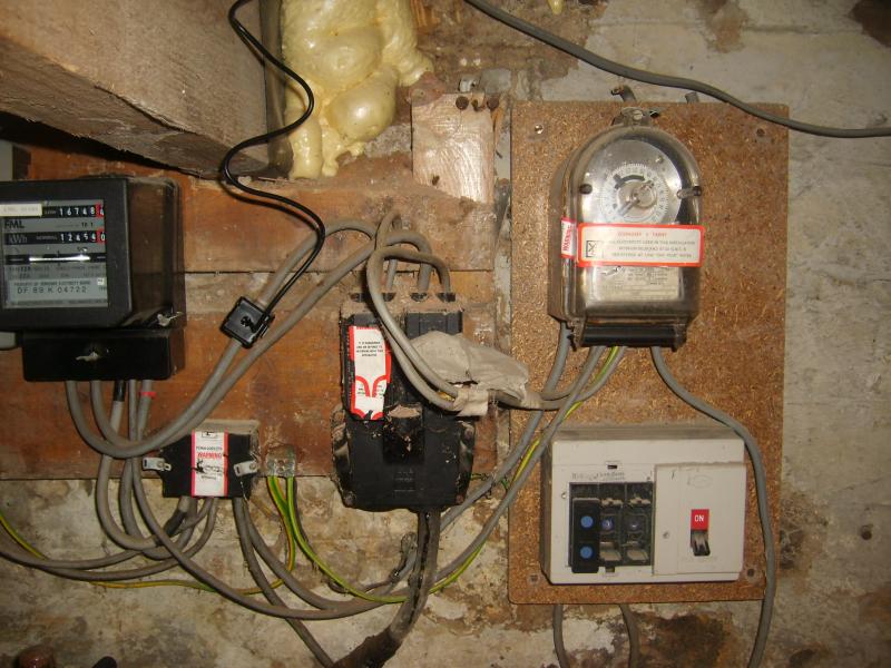

As promised, here are some pics of my meter & consumer unit set up... how bad does it look?
If someone could tell me what the different bits are it would be nice. I'm sure the bit bottom right is redundant.
The slightly concerning bit for me (though my knowledge of electrics is limited) is the consumer unit says max load 100A but it has 4x 32A and a 5A MCBs
I thought I had a radial circuit but the MCB is 32A and marked ring main.
The main intake is a bit messy, I would want to see the main supply cable clipped/supported. Given its age I would suggest you DON'T try doing anything with it yourself.
The left consumer unit is comparatively recent, has MCBs which protect the circuits satisfactorily and the PVC wiring looks comparatively recent and in neat condition. However there is no RCD protection which would give you increased protection against electric shock.

The total MCB ratings being greater than 100A is not an issue, your main supply will be 100A (or possibly less) and that's ample for most houses except those with large electric heating installations.
The right consumer unit (off peak heating?) is less recent. Rewirable fuses don't protect cables as well, are vulnerable to misuse by putting the wrong wire in. The two missing fuseholders and missing cover should be replaced but in reality this CU is overdue for replacement. Is this CU no longer in use? If not in use it should have been removed.
The earth terminal has 2 wires as far as I can see - one to the left CU and one to the timeswitch. So how are the CUs earthed to the main earth -- is there one? -- and where is the main bonding to gas/water?
The location looks vulnerable to damp - cellar?
I would suggest you need a new CU, main bonding checked, and any defects remedied. It's possible there were insufficient sockets and extensions to the original installation have been bodged, or you may want to have additional sockets or lights put in.
It's no longer acceptable to simply change the main switch for an RCD on the existing consumer unit.
But you probably don't need a full rewire. The apparent lack of main earth and bonding needs urgent investigation by a competent electrician, though.
Also if you no longer use off peak heating make sure you're not still on an Economy 7 tariff as they are more expensive
As owendiyer asks where is the main earth I cant see anything that earths this to the supply or rods.

I can see it. Bog standard either 4 or 6 mm earth as usual with a >40 year old YE TN-S supply
is it a bit of bare wire near that dribble of melted tar?
