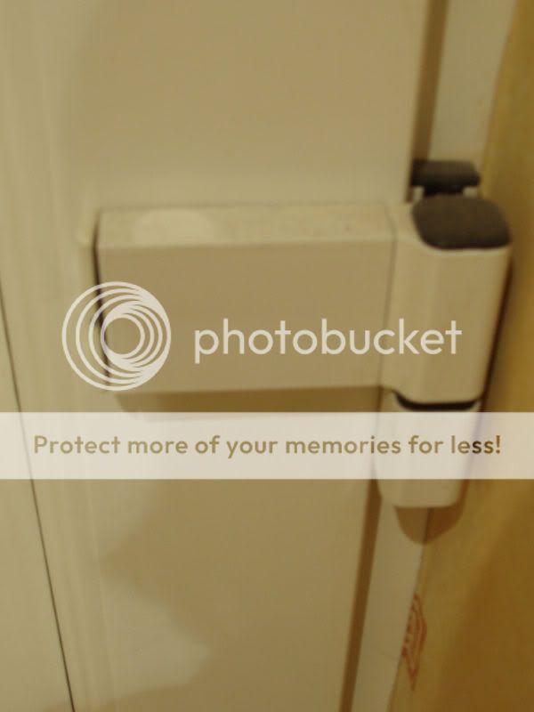

I have tryed an allen key on our door but it does not seem to move. The door has dropped slightly and is catching and I think its the hinge BUT I cannot seem to move it. Any suggestions?
Pics attached...
Cheers
John
The second picture shows a hole in the end of the flag hinge, with an allen key this will move the door sideways in the frame, sometimes you can stop the door catching by winding the top over to the right and the bottom over to the left using the centre hinge as the pivot, i did notice in the first picture though that there is no more sideways adjustment left as the door sash is hard up against the hinge.
The other adjustment left is the up and down, look under each hinge pin and you should see an allen key type hole, this is a bolt and if wound up will push the hinge pins up which in turn lifts the door up squarely in the frame, my advice is just do the middle one till it stops catching then wind the others up taking the slack out so that you have equal weight/pressure on all 3 pins give or take
Agreed, toe and heeling would sort it, at the same time i'd lower all the hinge pins and reset the hinges into their middle settings for the side to side movement that way you've stopped the door catching and gained back all your adjustments for future use if it drops again
Good point crank, its ok (good) to toe and heel, totally useless unless the hinges are set to a 'mid' setting.
And people, its not hard to do!
