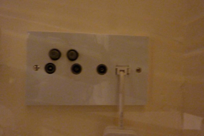

Hi

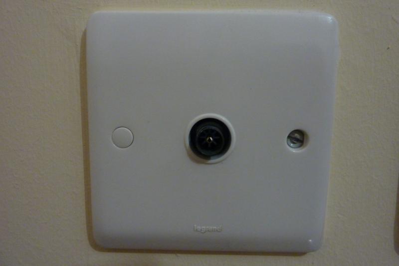

Have moved into a flat recently and have two TVs with built in freeview however can only pick up channels from one socket in the flat.
In the lounge I have this large plate with sockets labelled (left to right) SAT1, SAT2, TV, RADIO1, RADIO2 (obviously not including the phone line) and in the bedroom I have the small plate which is unlabelled.
At the moment the only socket I can pick up any TV channels with is the one in the lounge labelled TV, can someone tell me if this is right? And if so what are the other sockets for?
Thanks very much!

What may be happening is that the bedroom socket is fed from the male socket in your first picture.
In that case, the best way would be to connect the TV socket to the male one with a lead. Now try the TV in the bedroom.
If this works, split the signal and run one output to your main set, one to the bedroom feed.

If this flat is in a block of flats with a central aerial system then the most likely layout is as follows:
Sat 1 - for connecting a basic Sky box
Sat 2 - for connection the second feed to a Sky+ or Sky+HD box
TV - Freeview & analogue TV aerial feed - this is what you are connected to right now.
Radio 1 - Analogue FM
Radio 2 - DAB Digital radio
However, it's a bit unusual to have separate feeds for FM and DAB. Usually they are combined and te socket labelled FM/DAB. The remaining socket is usually the Return which is how you might feed an aerial signal to another room. Here's a wall panel with FM/DAB and Return sockets...
Continuing from the post of "ChrisFrost" which is excellent. Unplug the aerial lead from TV and plug it into return (So lead joins return to known good TV output) then try TV in bed room.
If it works then you know return is connected to bed room. If that is case there are two possibilities.
1) Cheap splitter.
2) An active link.
With the latter that could be an amplifier with two outputs or it could be a sky box which has two outputs the RF2 goes into return as that way a digi-eye will work.
At this point no point in going further but if you tell us what happened and what you have I am sure we can continue to give advice.
You need to establish where your aerial(s) is/are, whether there's a satellite dish, and whether or not they are connected to your flat.
Both wall plates have screws holding them to the wall. Unscrew the one with multiple sockets and determine what, if anything, is connected to it at the back. Do the same with the other one.
You need to establish if the single socket is fed from the back of the multiple plate or from another source.
You need to establish where your (or the building's) aerial is, and whether or not it's exclusively yours or a communal one. Whether you do this by climbing into the loft, onto the roof, or asking neighbours or a managing agent for the building is up to you, but you won't find the answer within your flat, or posting here.
just link a short piece of cable from sat2 into the return socket ,this will send free view signal to your other socket/s in the flat , if you intend on using sky then just feed from rf2 into the return as suggested
