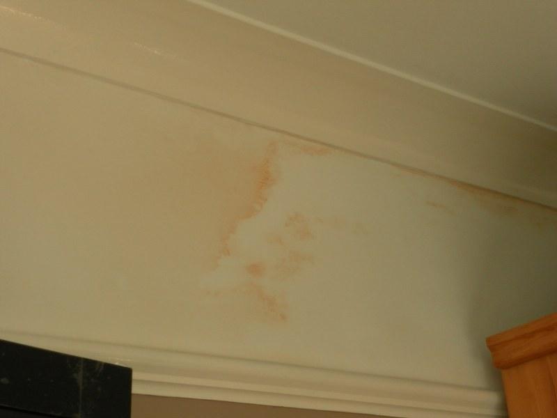

Hi all,
Does anyoen ahve any ideas of what might be causing this damp area please?
The wall is in the first floor master bedroom, and it is an external wall behind which is a chimney stack.
Initially i thought it might be some poor flashing ont he roof or perhaps mortar joint worn away inside the chimney stack. However we have not had much rain recently and the damp patch is getting bigger.
Could it be the warm air in the room hitting the extra cold wall (due to the chimney flu behind this) and condensing on the wall?
I had to admit it can be quite humid in there but nothing major and there is no sign of condensation else where.
I'm stuck :(
Any ideas please?

It looks like a classic case of damp in the flue. Is the flue used? if not it should be capped at the top with a ventilated cowl and also ventilated at the bottom.

Agreed, it looks like damp in the flue although where this emanates from will be another question. I'd cap the chimney with one suitable for still having your stove in (check with the flue manufacturer). This will reduce overall moisture in the stack due to rainfall.
It's also definitely worth removing the low level boarding - chimneys use to rely on the cycle of heating up and cooling to remove moisture but when chimneys aren't used this doesn't happen.
Whilst the flue is being capped, ask the builder to have a look at the flaunching, lead dressings and pointing to the stack. It may well be that any one of these are the main issue.
If the draughts are a major problem in the meantime, keep the boarding but install at least a brick sized vent cowl to the board.
Once the works have been done, keep an eye on the damp patch. Saturated plaster often doesn't dry out properly, and even if the original problem is sorted, the area will be prone to more condensation so you may have to re-plaster at some point.

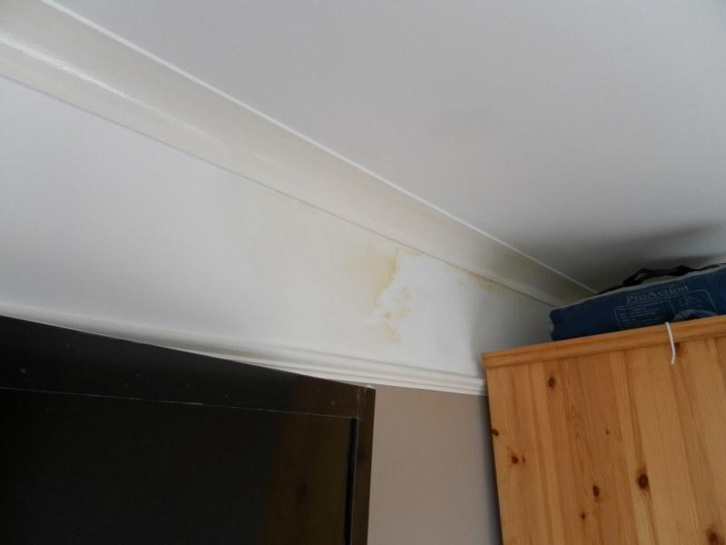

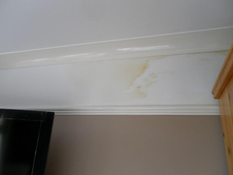

Hello all,
I'd like to update you on this problem ad ask for some more of your advice.
A few weeks have passed now and I have had a flu liner installed, wood burning stove and replacement chimney pot/stainless steel twin wall with top.
This chap (highly recomended) checked the roof while he was up there and confirmed that he could see no problems that might cause the damp.
To recap, when it rained prior to this work happening, it used to drip water down in the living room, down the chimney.
Since he has dones this work there has been no obvious signs of water in the stove. He didnt insulate the chimney but he has 'vented' it. I've had the wood burner on now and its certainly drying things out but then the weather is also drying up and the tempreture's are increasing.
(end of the waffle)

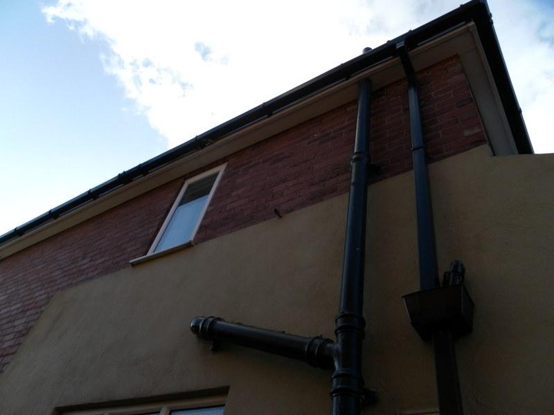

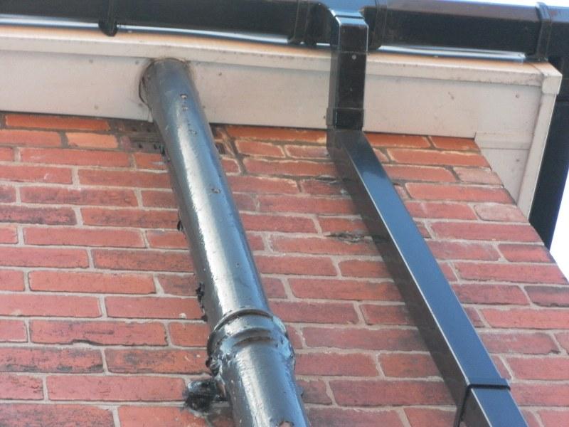

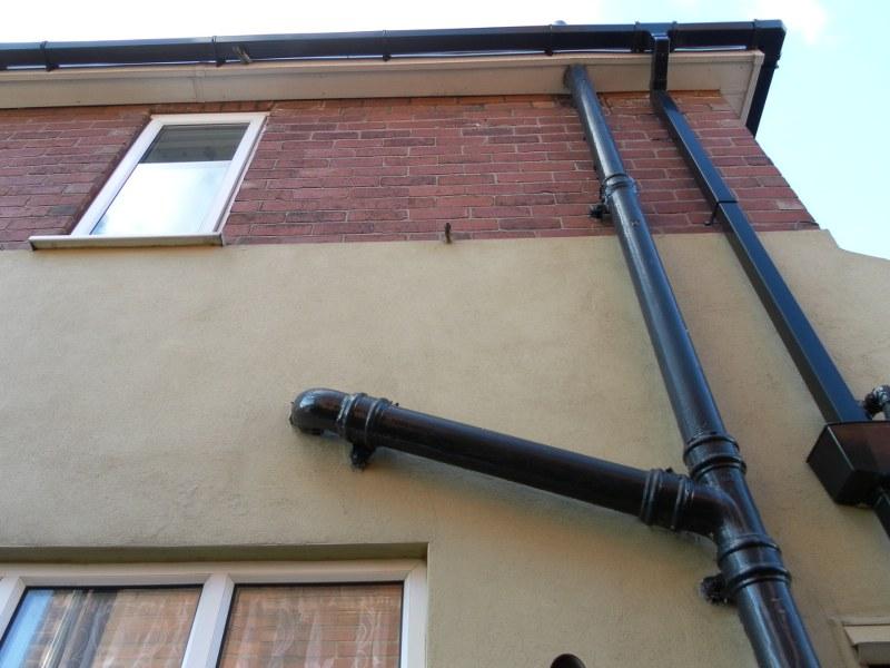

The damp seems to have spread a little since I last posted on here, see the photos...
My next door neighbour has the same problem in his house and he has told me that he thinks its the facia's and their lack of ventilation.
Is this possible?
I've attatched some photos for you to give your opinions.

May I also add please that I have been in the roof space (loft) when it has been chucking it down with rain, with a light and can see no signs of water running in or under the tiles. There is no damp in the roof and all the tiles around (or as close to as I can get) the area just above this room are bone dry.
