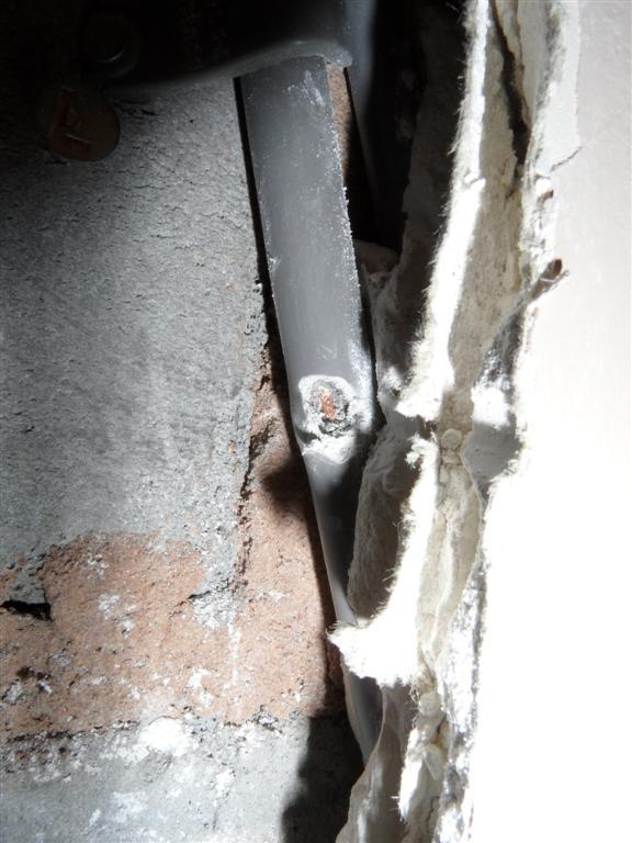

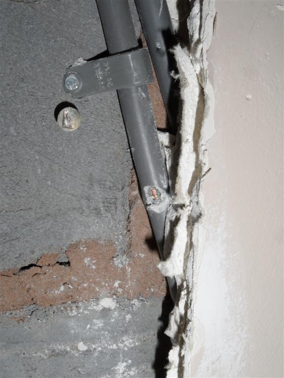

I am currently renovating the downstairs cloakroom. After removing the sink the drylined wall was a mess so I cut back the loose plasterboard but in doing so I have nicked the neutral wire of the electrical supply from the meter box to the internal consumer unit.
The meter box is externally just to the right of where those cables are coming in at a diagonal angle and the consumer unit is mounted up near the ceiling on the far left as you look at the picture.
The wall to which the cables are fixed is a thermal block and really should have been chased out and the cable inlaid before trunking over with steel conduit, but as you can see the electricians at bryant just surface laid them and didn't bother with the protective steel conduit over the whole length! Suffice to say this wouldn't have happened if they had done it properly especially seeing as that is where the toilet roll holder should be mounted and the previous owners narrowly missed screwing into the live feed!
My question is whether I can just patch the nicked neutral cable with some hotmelt glue or insulation tape or does the whole thing need to be taken out and rewired?

Has the copper been exposed/damaged. Repair may be possible in situ. with tape but you would need to be absolutely sure that the cable is intact.
If the copper is damaged then you need a competant electrician to replace or possibly mechanically crimp the cable.
Incidentally is this a fairly new build - I would be chasing the install company about breaches of BS7671 !
I would also not be happy about leaving that as it is either.
Thanks. The property was built by Bryant in 1996 and according to Taylor-Wimpey ,who now own the company, they only keep records of the build for 6 years.
The copper core is definitely intact and it is only the outer sheath that has been skimmed off by the plaster knife. (click on the pics for enlargement) Thank fook that it wasn't the live or I wouldn't be typing this now and would have missed the rugby today!
just wrap some insulation tape around it then, if you have a double pole switch near the meter before the cables come into the house switch this off, just in case they have used neutral coloured tail as the live

Wrapping tape around that damage cable is NOT the ideal repair.
There is a more serious concern. There are cables which have a 60 amp or 100 amp SLOW blow fuse ( the company fuse ) as their only protection.
They should NOT be hidden behind plaster without a clear indication of the serious danger to anyone fitting things to that wall. I am not so sure they should be hidden at all. They are close enough that one screw of a metal fitting could go into the neutral which would not be noticed and the second screw goes through the live. 60 amps through a toilet roll holder would be spectacular and extremely dangerous.

And thats why you are not competant to be thinking about anything to do with electrics. Most silicone sealants exude acetic acid (vinegar ) whilst curing, thus damaging the copper conductor. The only way to repair this cable would be to use a form of self amalgamating tape such as the link below
http://www.alfatape.co.uk/
Please do not suggest stupid ideas to repair things such as this as there is always some idiot who will try it and then end uo killing themselves .
Those cables are not in the prescribed zones and so should be moved to comply witht he regulations. Is their not a sticker on the DB with the installers name and address??? if so go to the trade body they are registered with and lodge a complaint.
