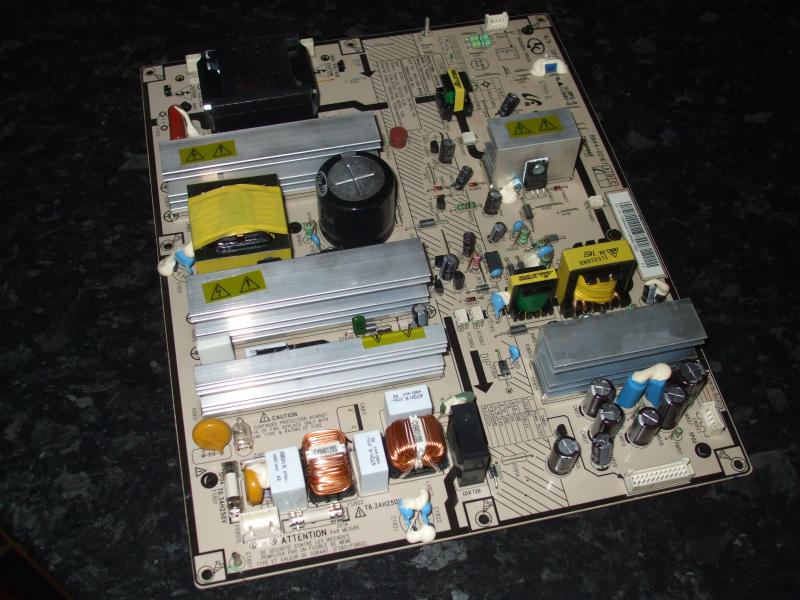

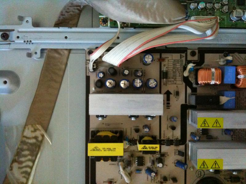

TV with rear removed showing PSU Board. note this is not the same PSU board as the one I found a post of on the net, it was in the US so for a different supply voltage.
Note: Don't, as I did, do this with the TV standing up. Some of the screws (marked with an "S" hold the stand on and the TV is very loose on the stand when all are removed. Do it with the TV laying flat.
PSU Board removed - 6/7 screws and several connectors.

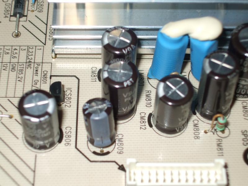

Failed capacitors - see domed tops on the two central capacitors.
Maplin have what appears to be the same thing for about £1 each. First thing is to remove one and have a closer look.
Check CM809 aswell. Sometimes instead of the top splitting or bulging they can push out the rubber bung at the bottom. CM809 isnt flush to the circuit board. maybe it was just soldered that way or it might have pushed itself off the bung.

Had a look at CM809 and it looks OK, not soldered close to the board as the pin spacing is less than the hole spacing so one pin is bent to fit.

CM809 is a 220uF 25V 105C - will a 220uF 50V be OK or is that going too far?
No that would be fine. You can increase the voltage rating as much as you like as long as the higher voltage one will still physically fit.

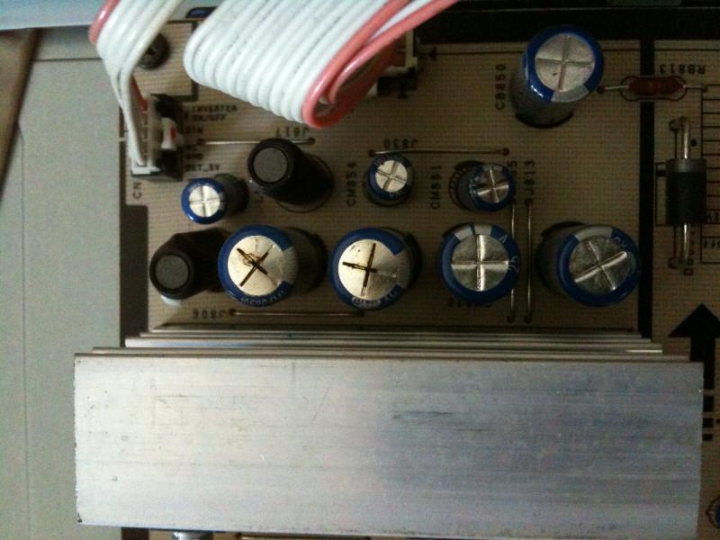

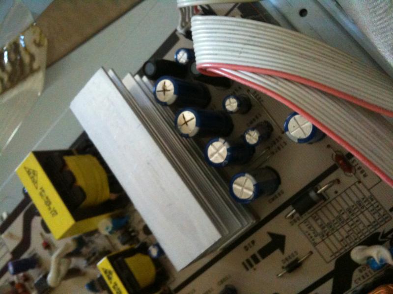

Hey all,

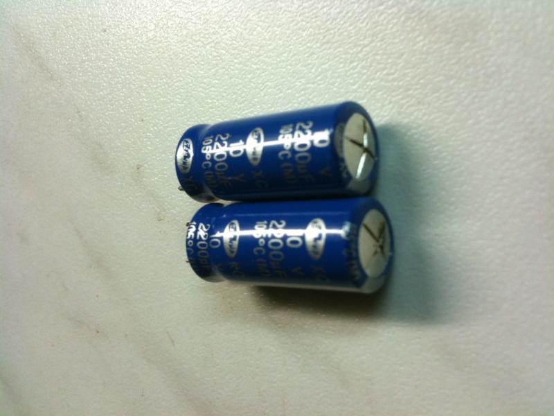

my first post here since i found this post/forum by google because i had the same problem with my Samsung TV (le40m87bdx). The cause of the problem was also 2 capacitors which i changed myself and saved 35 euro for the check from the technician + who knows how much to repair it.
Here are 4 pictures from the damaged capacitors. They were 2200μF/10V but in order to be sure that in the future there won't be any problem and to make sure they will last longer i put 2200μF/16V (slightly larger but they fit ok).
