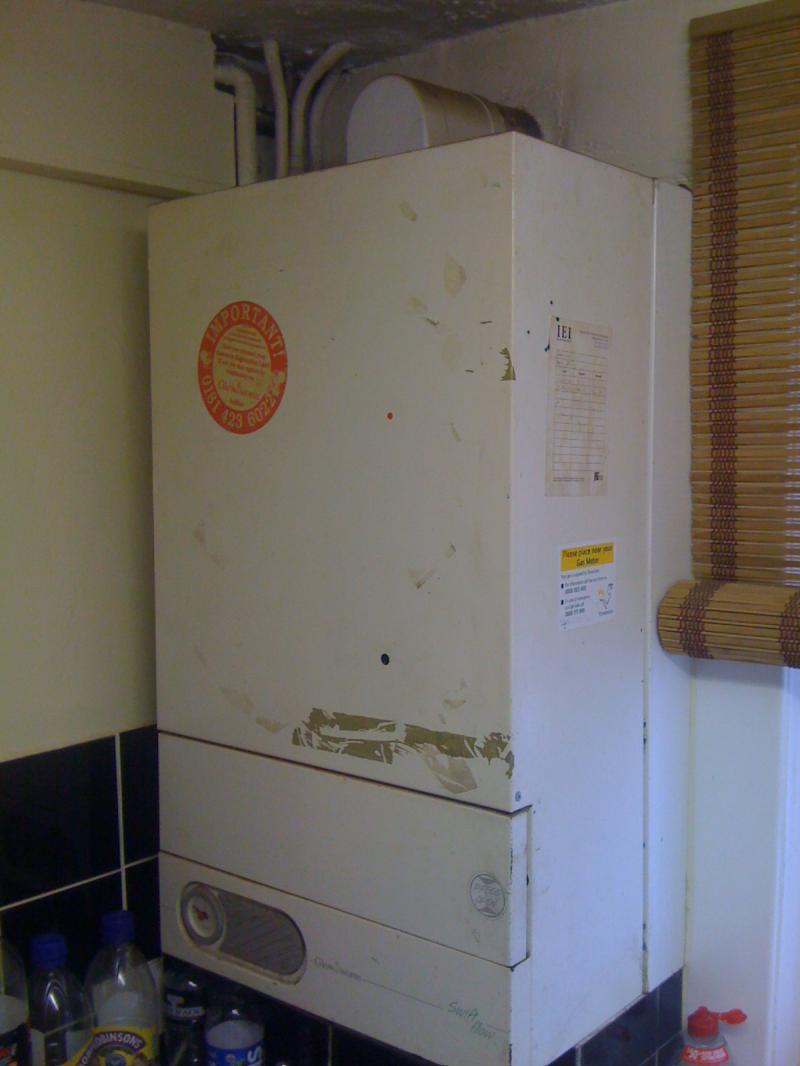

i sealed the piped under the floorboard but i have about 2 and half meter of dead leg.
if i want to cut the pipe at the branch or nearest tee it will be under the boiler.
boiler is on top of my kitchen sink so to get acess to the tee i have move the whole sink as well as the worktop , big hustle.
is 2 and half meter dead leg too long to leave it there?
i have attached a picture of the sealed pipe. as you can see pipe went down the corner into the kitchen below.
