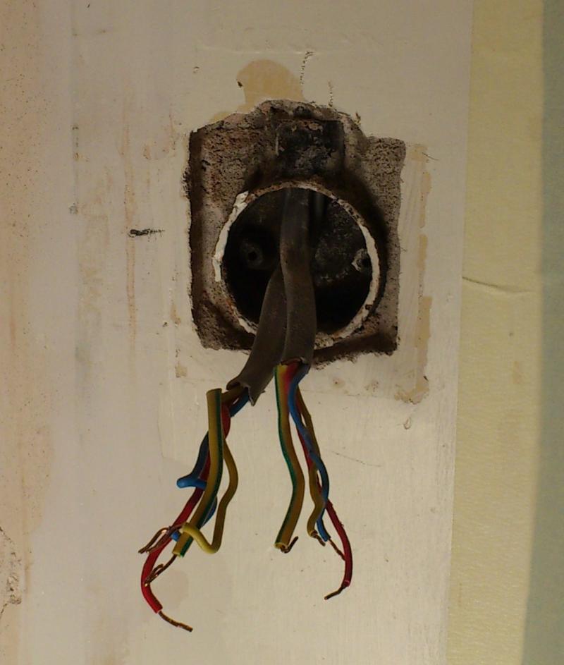

It is most likely cast iron which makes extraction easy than you think once you know how. The trick is to use a Dremel tile cutting bit in a drill or one of those multitool things to cut a neat square out of the plaster back to the brick exposing the cast iron fitting which is screwed onto the steel conduit.
To remove the cast iron box thing you now take a cold chisel and wearing eye protection wack the cast iron box. The best place is around where it is attached to the conduit. The cast iron box will crack/shatter allowing it to be removed (watch it will be razor sharp) leaving the steel conduit undamaged.
You can now fit a standard metal back box. Most likely it will need to be a 25mm deep one and you will probably need to use a step drill to make a hole in the right place to fit over the left over metal conduit.
Done several of these in my house, as when it had been rewired all they did was screw surface mounting boxes over the top. The first one I took out I pulled out the cable and used an angle grinder to cut it. Not a good idea as it creates an awful mess.
Here is a picture of the last one I removed, you don't even need to withdraw the cable from the conduit.
