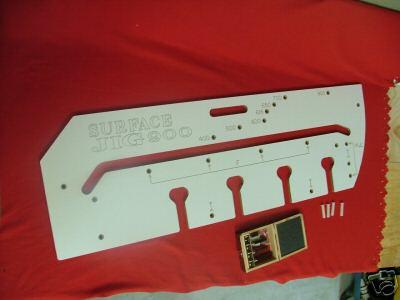

I have bought a jig and router to do the worktops in the kitchen I am fitting. I have used a router before so I am confident in doing the joints.
However, as in the posts above, my walls are not 90 degrees to each other and I have realised that the jig will not suit the angle required.
If I put the female side of the joint in at 90 degrees with the jig the male side will have to be adjusted to enable the length of the wortop to fit parralel to the wall.
Above you have quoted "Turn the worktop over and using the jig with the pins in the male holes line up the template edge of the jig with the line you have just drawn making sure that the pins are tight up against the postform edge.."
I understand the theory of this but, if you place the pins hard against the edge, won't this still produce a 90 degree angle?
Thank you for posting the link.
I presume then that the only way of doing a non 90 degree joint is to use a jig capable of these joints - such as the Trend one you pointed me to?
The jig I have is only a basic one and does not seem to be adjustable.
It is one I bought off Ebay - I don't think it is any known make - just has
SURFACEJIG 900 marked on it
Probably too small a picture to make out details but it might help.

I think I get what you are saying but by changing the angle of the female cut you will be making the radius of the first part of the cut and making it shorter at the same time you would be making the male cut radius longer so you would end up with an exposed bit of chipboard.
I spoke to Trend and they reckon that by adjusting the male cut you could acheive what you need (as in mifty's post) I think they recommend no more than 3 degrees off to avoid the exposure problem.
