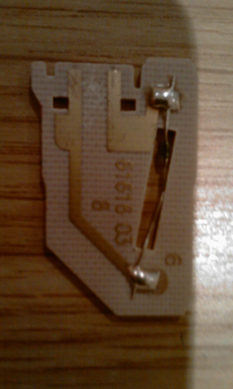

Having same problem, have done all in this thread but still no go. It is fair to say that a reed switch is either on or off, so would be fair to say, to test the reed switch you could just complete the circuit by running a cable between the two connectors. Again this wouldonly be a test and not a solution but I am assuming that the control unit is not expecting a certain amperage to be returned and that the reed switch does not return varying signals? I am very new to this, first dishwasher/first problem and it is driving me completely mad! An new reed switch is coming in at £65.00 so need to be sure it is the fault here. Please reply and help me with this!
Reed switch is either on or off but the water flow into the machine causes the reed switch to produce a stream of On Off On Off signals that is converted into water volume. Ie it measures the amount of water being allowed into the machine. So it is the varying signal that is needed.
I discovered this shortly after writing that post, thanks for confirming it for me. I have now finally fixed the fault, here is how I did it for anyone who wants to save some money.
1. Whirlpool, espares..etc would only do the part at cheapest for £80, I wasn't going to take this risk that the reed switch was not the fault so I took a chance...!?
2. Purchased the following reed switch CL37S, all ratings, sizes seemed most plausable.
http://www.maplin.co.uk/Module.aspx?ModuleNo=12389
3. Soldered it into the PCB, photo attached of the PCB with old (broken) reed switch.
4. Hey presto, the dishwasher worked like new.
Saving of £79.00 as the reed only cost £1!!! I am a very happy man, the kitchen is clean, and I have saved a lot of money!!
Thanks for all your help with this on the forum, great website and first time ever on it, DIT is not my strong side! I hope my experience will save others money when they have the same problem as I did.

Reed switch PCB with broken reed switch (by me..!!!)
Location of reed switch PCB
