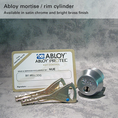

Abloy cylinders are available as replacement parts to fit many applications, they are curiously expensive. The key is like a half-round bar with notches in it.
Both these cylinder keys are very small and easy to carry around.
You can make out the Chubb Ava key here
And the Abloy key here
