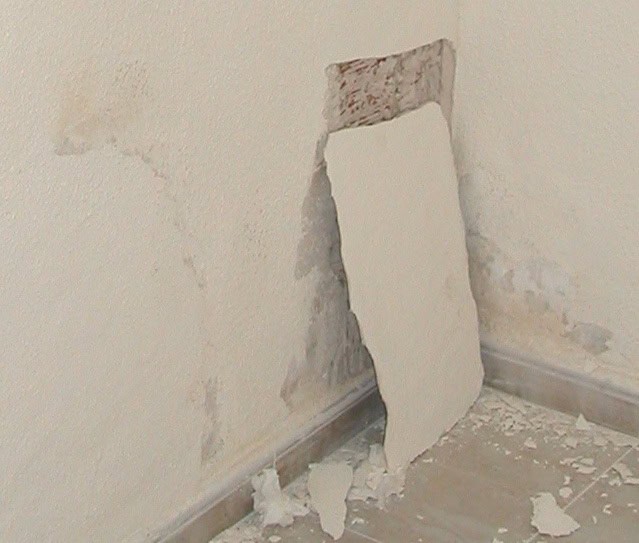

  • 20-30%: Raised moisture levels – could be recent water ingress or drying out after a leak.
  • Above 30%: Usually a sign of trouble – either active damp, trapped moisture, or plaster contaminated with hygroscopic salts (which draw in moisture).
Bear in mind that upstairs walls can sometimes give higher readings than expected, especially if they’ve been recently wet and are drying out. Likewise, chimney breasts or solid walls can retain moisture longer, especially if water has entered through faulty roof tiles or flashings.

It’s not uncommon to find high readings on a chimney breast where rainwater has come through cracked roof tiles and run down into the masonry. Even after fixing the roof, the chimney can remain damp for weeks. In such cases, the plaster can take a long time to dry, and salts can cause lingering high readings.

If your meter consistently shows high readings (say 25%+) in the same spot weeks after fixing any known leaks, and there are visible signs like mould, peeling paint, or tide marks – then it’s time to investigate further. Alternatively, should the meter readings fluctuate depending on time or place, and the room feels warm and dry, then chances are you’re just seeing a normal seasonal variation.
