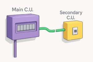

What Is a Sub-Main?
Main Consumer Unit and Secondary Consumer Unit
In simple terms, a sub-main is a cable that feeds power from your main fuse box (consumer unit) to another smaller fuse box elsewhere in your property – perhaps for a garage, extension, or in this case, new electric heating.
