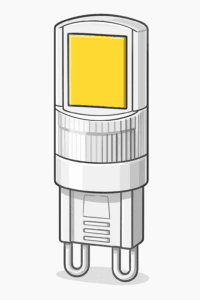

Understanding the G9 Bulb
A brief explanation of G9 bulbs should come first. The G9 bulb represents a small bi-pin light fixture which is widely used for contemporary lighting applications throughout kitchens, bathrooms, and hallways. G9 bulbs operate through their two looped pins to enter their socket differently than traditional screw-in bulbs. The small size of G9 bulbs makes them suitable for specific fittings but makes removal challenging when they get stuck.

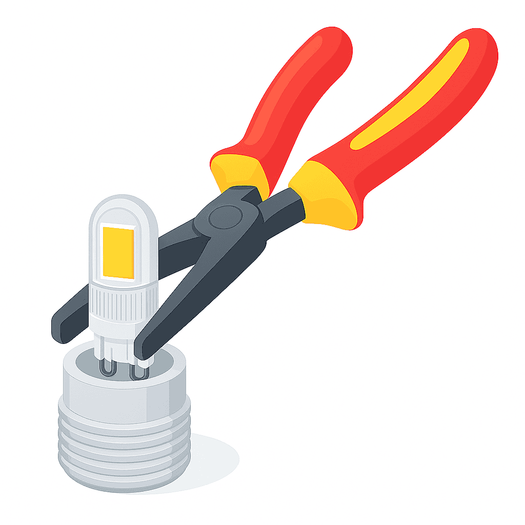

2. Thin Nose Pliers
When fingers do not provide enough grip, thin (needle) nose pliers should be used. The light pull and wiggling motion should be applied to the ceramic or metal base while avoiding contact with the glass part. The bulb could break if you press too strongly, so handle the pliers carefully.
