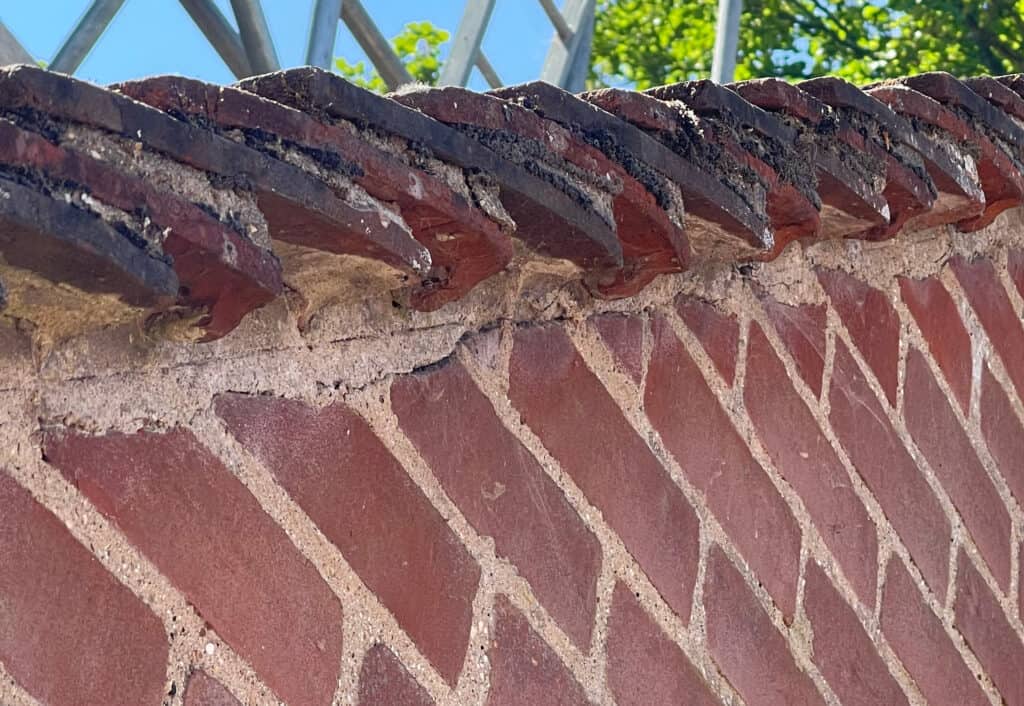

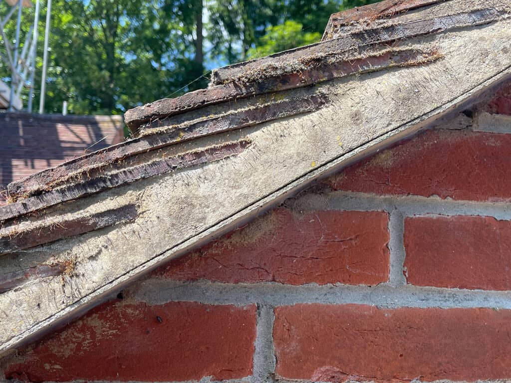

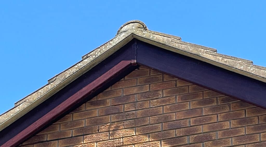

The verge is the edge of your roof where the tiles meet the gable end. It’s traditionally pointed with mortar to hold the tiles in place and protect against wind uplift and water ingress. This pointing can crack or fall out with time, allowing in moisture and potentially dislodging tiles

If the gap between the tile and the wall is large it can lead to shrinkage and cracking once the mortar dries. In such cases:
- Insert slivers of tile or slate into the gap before pointing.
- Use a wider bed of mortar to ensure strength.
- Reduce water in your mix to avoid shrinkage.
