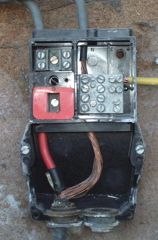

Straight Concentric Cable
This is a DNO cutout supplied by a straight concentric cable.
(This is a TN-C-S supply)
Split Concentric Cable
This is a DNO cutout supplied by a split concentric cable.
(This is a TN-S supply)

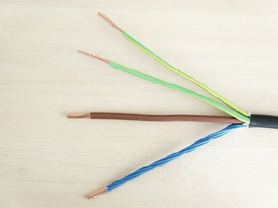

Split Concentric Cable for installations
Some pictures of split concentric kindly provided by Lectrician
The cable with the sheath stripped back
After its prepared; the earth is sleeved as two separate bits to keep it tidy

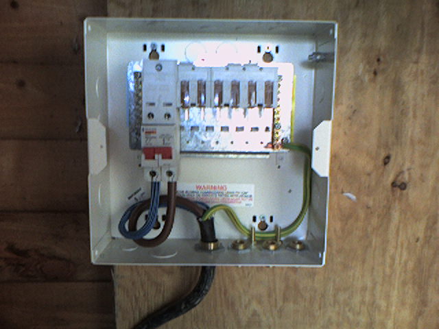

25mm² Split concentric terminated in a consumer unit through a bush and locknut
