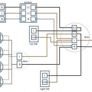

    New extractor fan in bathroom
    Thanks Sparkyspike. I hadn't thought of the override switch option. As for the junction boxes they would be screwed to the sides of the joists in the loft and easily accessible. However if it is likely my LABC would rather it was done the way you suggest I could change it. I'll give them a ring...
    Apologies before I begin on the rambling nature of this post. Moved into my house a year ago an it needed an emergency re-wire. All done and certified but we didn't really have a lot of time to think about what we wanted and now the missus wants the light in the bathroom changed and a fan...
