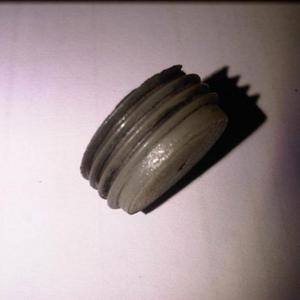

  5. m33ksy
    Radiator Cold Goes Hot When Bled Then Cold Again
    Hi it's now working fine. Took the radiator off to flush it and some blackish water came out but not really any sediment but realised water was only coming out one end. Turns out the side the trv is on the radiator had a plastic cap screwed in it no wonder no water was flowing! I guess the...
