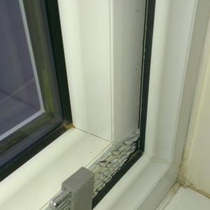

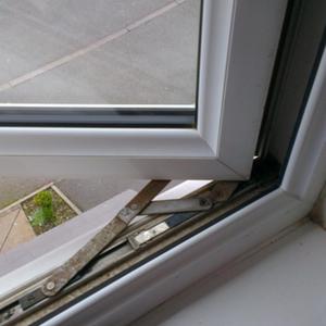

    Gap between window and window and window frame (UPVC)
    Thanks Pinnacle, Turns out that none of the ones at Screwfix will fit as the window arms are too long - it also turns out that the windows are from a company called Speedframe (moral of the story, don't ask the misses to look). After some reading, it looks look Speedframe made generic...
    Thanks Alan & Pinnacle, I'll get a new set of hinges from Screwfix and see if that does the trick. Any advice on the best way of measuring the existing hinges to get the right size (I've measured the hinge 'running plate' that fixes to window frame) and replacing the hinges without dropping...
    Afternoon All, Wondering if you could help me - bought a 6 year old house a month or so ago and I'm slowly working my way round fixing all the odds and sods but have come across a gap in one of the windows that has me stumped. The gap is about 10mm between the window and the window frame...
