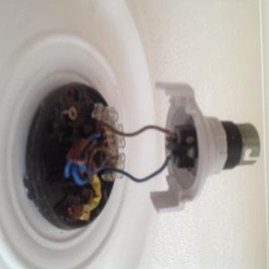

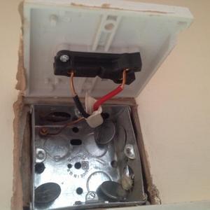

    Lights failing for no logical reason
    Riveralt and Lectrician, thank you very much, loose wire on the ring main on front bedroom rose!! Once again, thank you very much! Regards Neil
    Hi there I have taken photos of both the switch and the rose, does this tell you what system mine is? Genuinely really appreciate your help! Regards Neil
