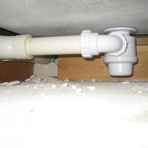

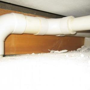

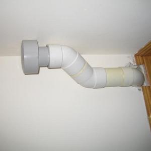

    Shower plumbing - air admittance valve?
    I've attached some photos of both the shower waste under the shower tray itself, where you can just about see the branch from a t-piece going through the stud partition - the first photo shows what is inside the wardrobe, though the picture is 90 degrees in the wrong direction. In terms of...
