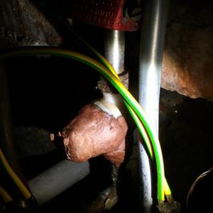

    Strange valve? underneath bath
    the cold is mains-fed, and the hot is from an old combi boiler with not particularly good flow rate so i guess it is possible this is a PRV? it only seemed to drip-leak after the cold water tap is turned off, not whilst it is running. i hope they're all a standard length as it looks...

    If I just took this out and replace it with normal pipe, what's the best way of bridging a short (~10 cm) gap like that? A flexible hose would probably have to be bent too sharply to work?

    it's really hard to get the putty off! it's basically a short horizontal cylinder coming off the vertical pipe with a hole in the centre of the end face. on the other side there's an even shorter horizontal cylinder with a blank end face. what normally goes on the cold water supply of a...

    Hi, There is a white plastic valve? connected to the cold water pipe running up to my shower (see photo). It has a small hole in the middle of the end face. Recently it has been, very slowly, leaking so I tried covering it in plumbers mait, which didn't work. What is this part? Could i...
