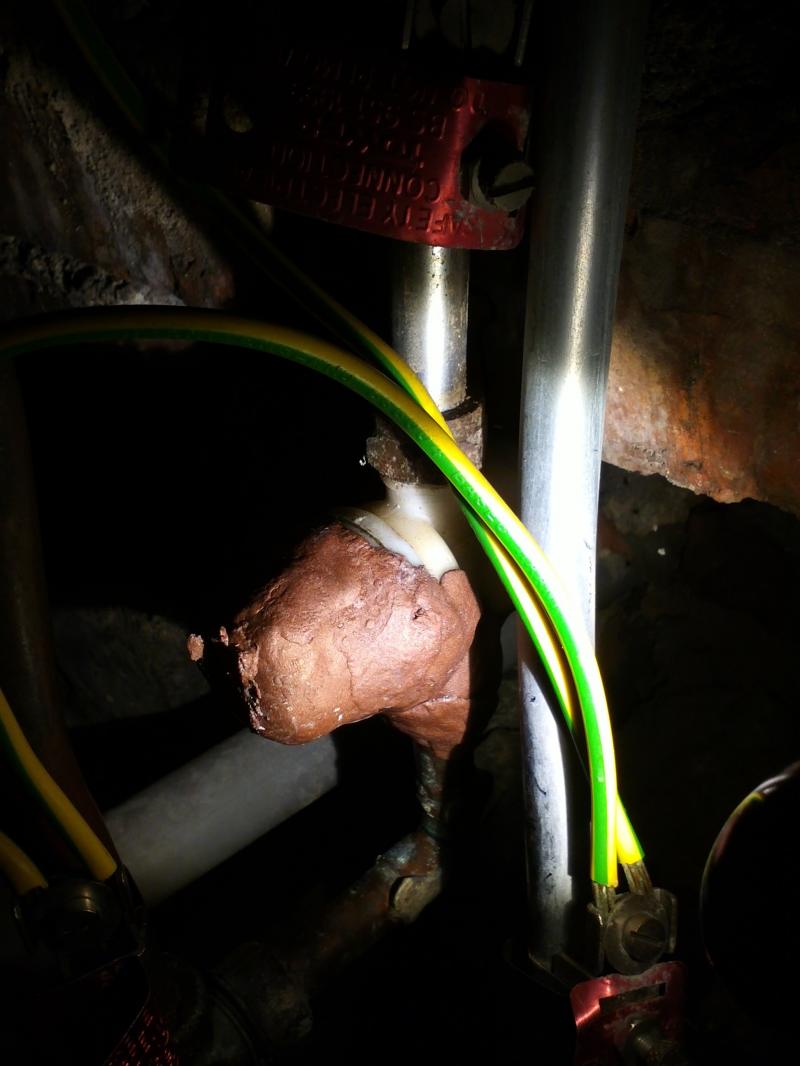

Hi,
There is a white plastic valve? connected to the cold water pipe running up to my shower (see photo). It has a small hole in the middle of the end face. Recently it has been, very slowly, leaking so I tried covering it in plumbers mait, which didn't work.
What is this part?
Could i replace it with a straight section of pipe or is a replacement part obtainable?
thanks
cant really identify it, looks like someones taken a dump on the pipe, take the turd off so we can see whats underneath
it's really hard to get the putty off! it's basically a short horizontal cylinder coming off the vertical pipe with a hole in the centre of the end face. on the other side there's an even shorter horizontal cylinder with a blank end face.
what normally goes on the cold water supply of a standard (non-power) shower? or are they connected directly off the mains pipe?
If I just took this out and replace it with normal pipe, what's the best way of bridging a short (~10 cm) gap like that? A flexible hose would probably have to be bent too sharply to work?
It could be a pressure reducing valve. Are you on mains cold, tank fed hot?
the cold is mains-fed, and the hot is from an old combi boiler with not particularly good flow rate
so i guess it is possible this is a PRV?
it only seemed to drip-leak after the cold water tap is turned off, not whilst it is running.
i hope they're all a standard length as it looks like i need to replace it!
I would hazard a guess as it being an old gate valve which had leaked at the gland/headgear and which some bodger had "fixed" with 2-part epoxy putty.
I doubt it serves any useful purpose.
