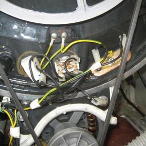

    Hi assuhors, well I first put the T 90 wires to the top and the T 30 wires to the bottom of the thermostat, ran the washer and no heating of water took place, so I reversed the wiring and tried again and it is now heating up ok. So thanks for your help on this matter.

    Hi, I have not got a meter so it might have to be be trial by error, I will let you know the outcome.

    Thanks for the reply assuhors, the thermostats are as you say 2 terminal and four. On the four terminal thermostat, do the T 30 wires go to the top or bottom or does it not matter as long they are connected to the same cut out circuit.

    Hi, I have just fitted both drum bearings and seal but I am not sure about the wiring to the heater element and two other small devices that I had to disconnect, all eight are black with white lettering, two have just the letter R, two have T30, two have T60 and two have T90. I have tried to...
