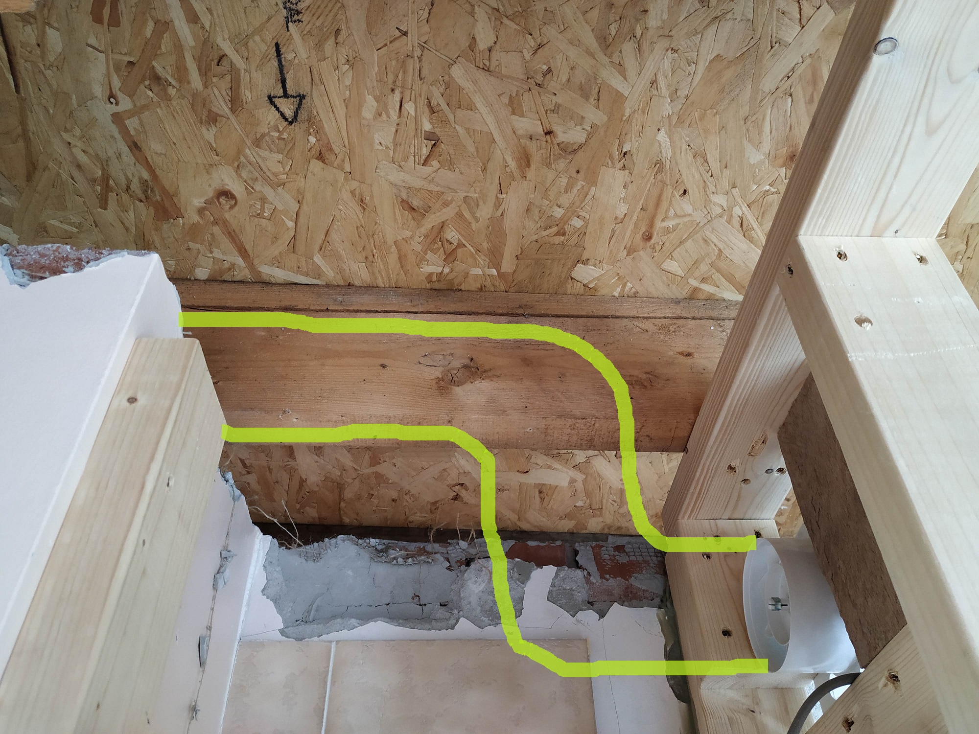

originally there was no extraction in the previous bathroom so to cover all bases i've had a fan installed by an electrician. This is sitting mocked up in the rough location on a stud wall, i now have to decide where/how is best to exhaust the fan to outside before progressing any further with the insualtion.

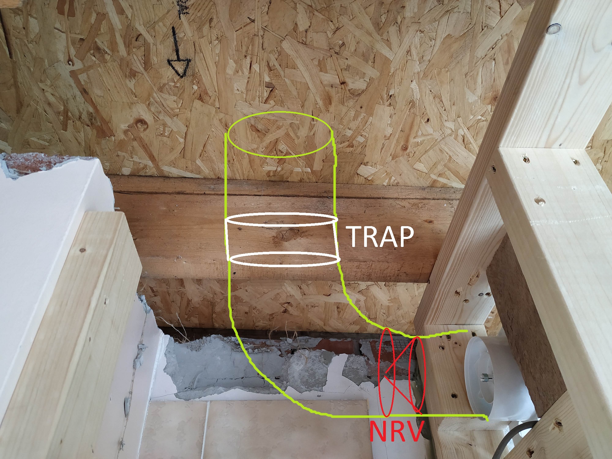

1. use rigid 100mm pipe install a non return vallve, come out 90 degrees, then install a condensation trap, then through the epdm roof.
if it can be made to work then this is my preferred option as i think it will be easiest to insulate around and requires the least material.
problem is i cannot find a 100mm vent suitable for an epdm roof, would a universal boot similar to what is on the soil pipe vent stack do the same job?
i also cannot find any 100mm pipe that looks suitable to exit the roof, should i be looking at using 110mm soil pipe to go through the roof then use a reducer to connect up to the 100mm stuff inside?
heres a terrible pic to hopefully show what i'm trying so say:-/

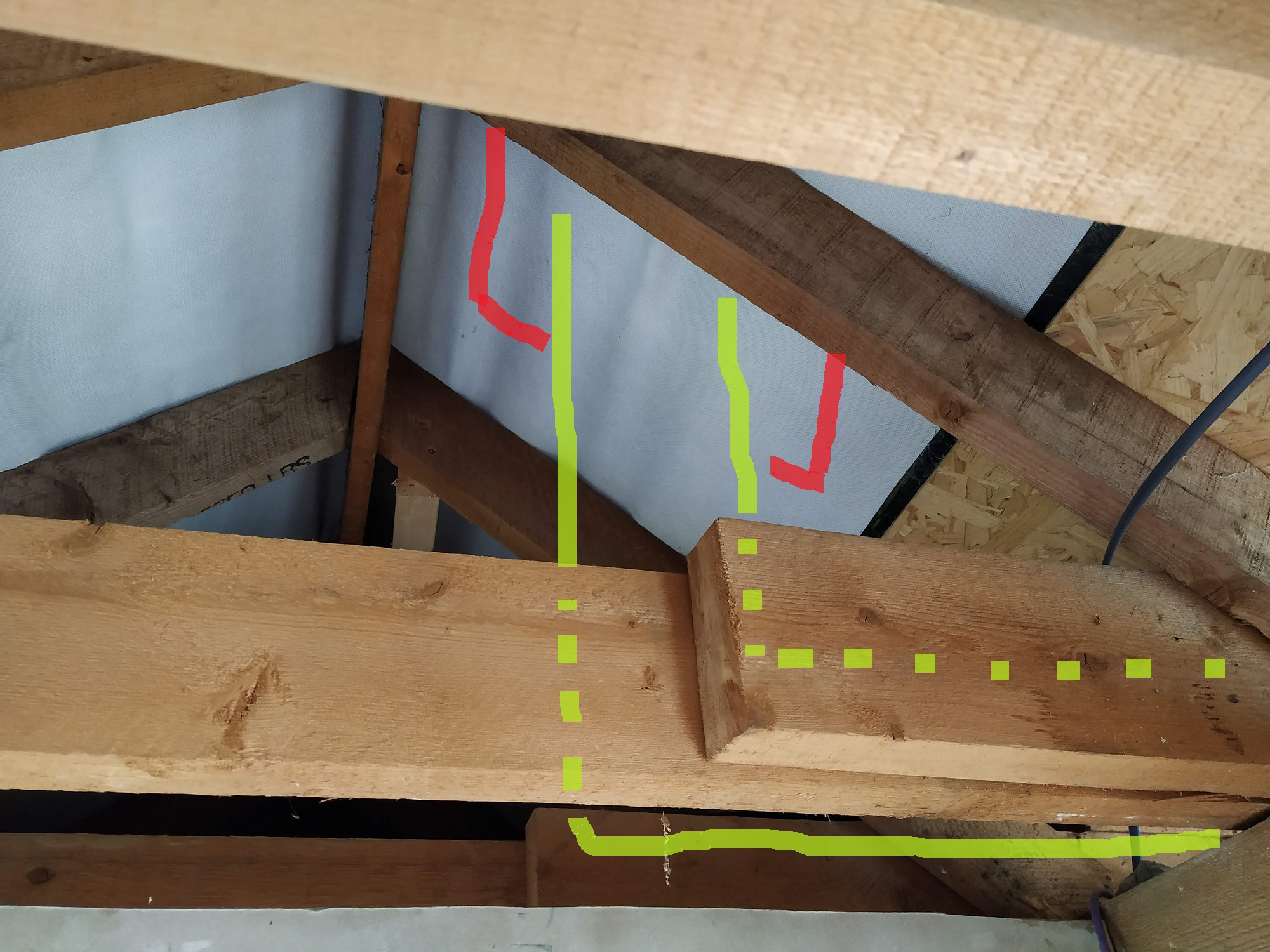

the other option is to run flexible or rigid 100mm from the fan along the rafter into the centre of the house where the small roof apex is. Then install a vent tile and connect everything to that.
this will be harder to install all the insualtion etc but seems to be more off the shelf items available to make it work.
