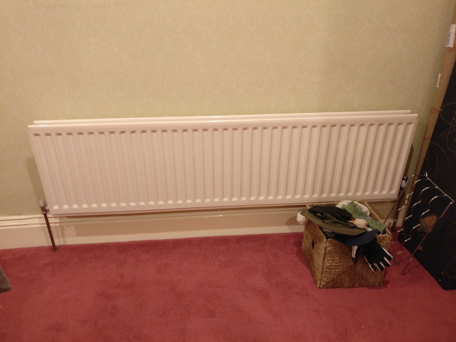

We have some fugly, huge radiators in the two front rooms of our Victorian house. Both rooms are approx 15foot square, 9'6" ceilings with external double-brick (uninsulated) walls on 2 sides and single glazed bay windows 6-7sq m per room.
Existing radiators are double panels 54cm high, 195cm long dominating the whole walls they sit on - assume previous owner renovating the place just bought the biggest damn things they could find.
I don't have kWH/BTU figures for them and can't even find anything that long, but am guessing new ones would be rated about 3kW/10,000BTU?
Thing is, a calculator online suggested I need more like 13,000 BTU (3.5kW). We want to replace them with taller, narrower, nicer ones to get some wall space back. I was looking at tall (1.8m) narrow ones instead... personally I like them but I don't know if they are in keeping... would older properties have used these?

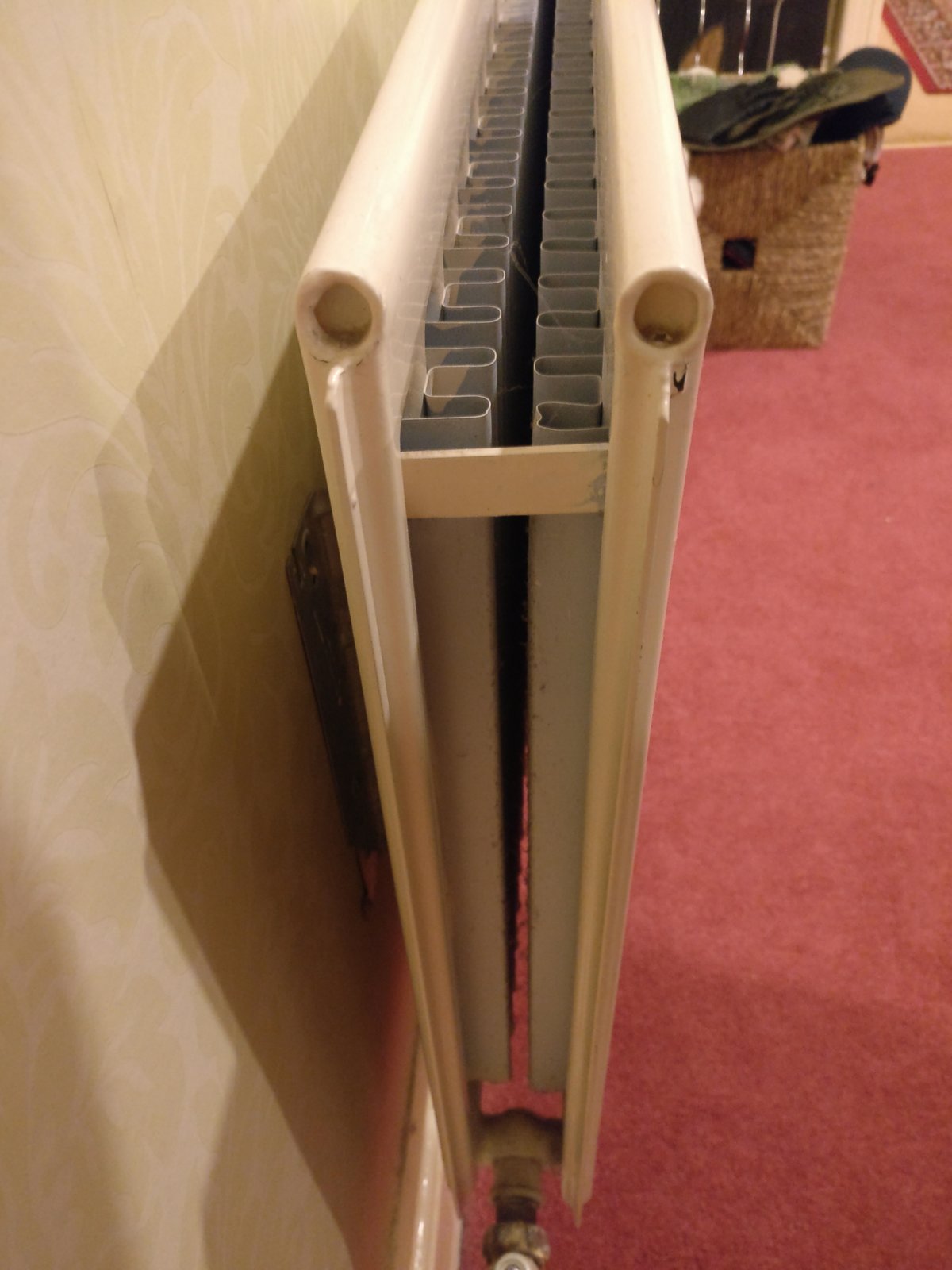

Can anyone help me guess the rating on my current radiators? As I said the panels are basically 200x50cm and look like this...
I can look up new radiators if similar size and appearance but mine are at a guess 20-25 years old and I've no idea if things have moved on... Or if they might have degraded over time.

Assuming mine is a double convector then that link says theirs are rated up to nearly 12000 @ 50... IS that what I've got in my photo?
Temperature wise, all I know is when they're running full blast, they're too hot to touch for more than a second or so, but not so hot they'll immediately burn you like old school heating pipes. So... 70C?
Yours look to me like they are the double convectors and the newer 530 x 1962mm in the list I have is rated at just under 10800.
Probably is 70c which is wasting gas, if you can get away with it your condensing function will be used if you turn it down to the minimum acceptably, ideally around 55 to 60.
