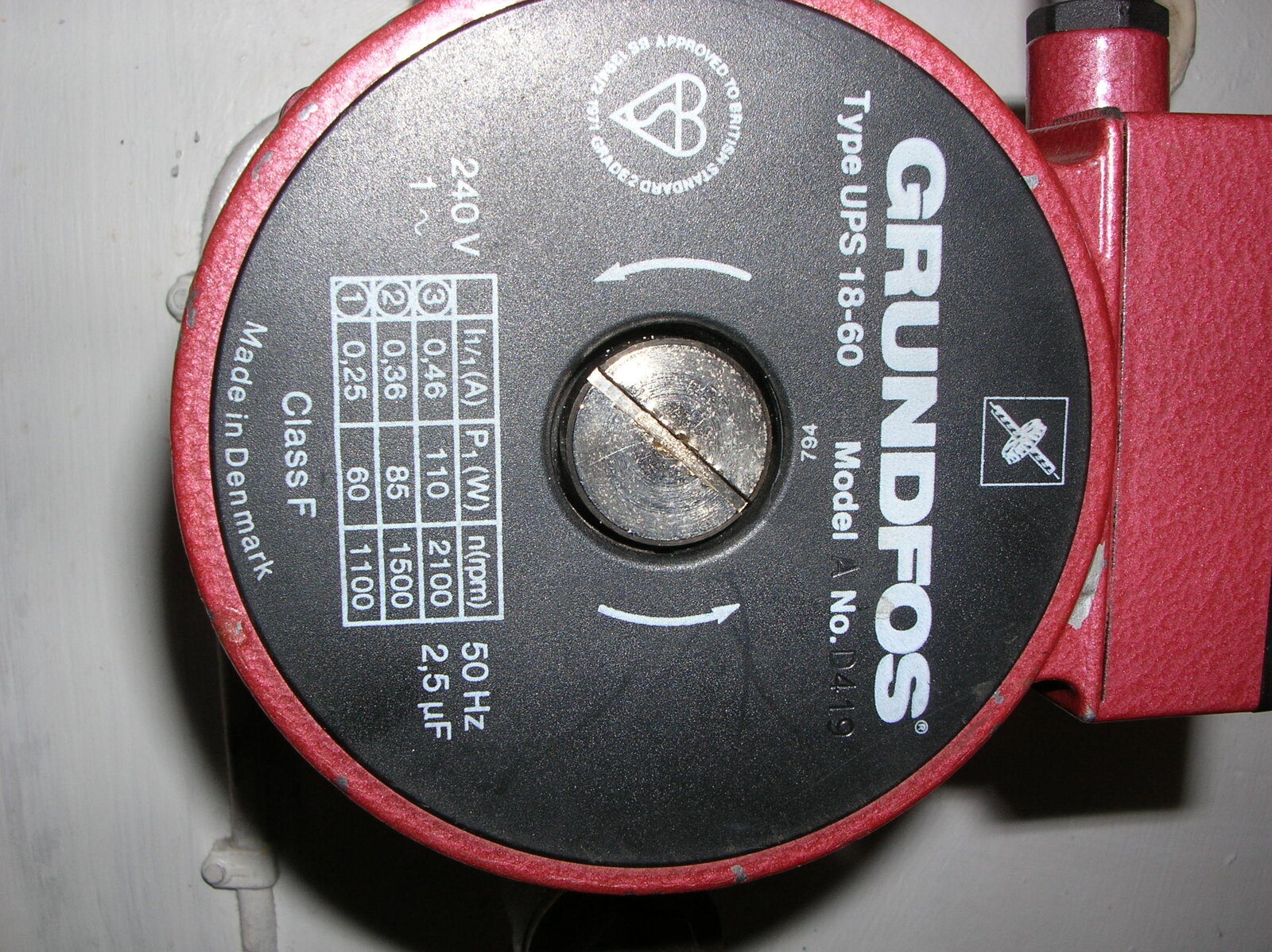

I don't like things I don't understand so I rooted out the original pump (This is the Grundfos 18/60-130 of 1983-4 vintage) which I vaguely remembered taking apart and there were some loose bits in the impeller and concluded that a foreign body had got in somehow. With new-found ideas, I tested it's capacitor labelled 2.5uF +/- 5% and it was down to 1.95uF so that was quite probably the original fault. Some options have opened up with a proven 2.48uF capacitor out of the useless motor to hand, but not on sunny days.

Is your system OK now that the pump isolating valves are fully open and what pump did you or your plumber install?, Your 1983/84 pump is probably a UPS 15 60 130 and not a 18 60 130 which I've never heard of, can you post a photo of it's label?.
Ah, not old enough? There are no records of it anywhere. The stamped in bits read Model:A and NoD419. I assume it was scrapped as a size in favour of the 15 60 or the 20 60.
