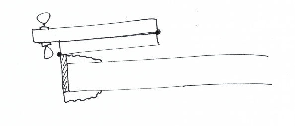

Yes, that's what I thought you meant. Is this a room door - if so you wouldn't use cabinet hinges. To fold flat, one option is to make the door lining as wide as the architrave, and put the architrave behind the lining instead of on top, that way the hinge knuckle can be placed so that the door can fold right back on itself.
Perhaps a sketch of what you are trying to do?
The devils in the detail. This is how I would do it.

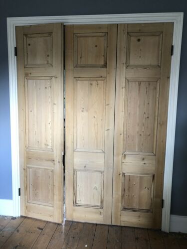

I bought these of ebay about a year ago. One pair is hinged together
Did you use a door maker and does the hinged / bifold door lay flat against the wall?
Those are original Victorian/Edwardian.
I paid £100 but that was bloody cheap, even if I had to do a 60 mile round trip to collect them
Yes they fold flat
