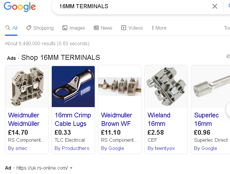

If it's going in a galve box I'd tend to go for din terminals.
Picked at random:
But maybe that's just because I'm a panel guy and would have had stock.
